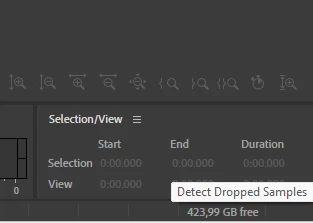

I wonder about the field down to the right in Edit View: "Detect Dropped Samples".
I experience dropped samples while recording in Edit View, however they are never reported by Audition in this field.

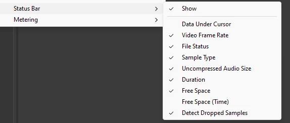

In Edit View there is a field as in the above screengrab. The question is what sort of dropped samples is detected?
