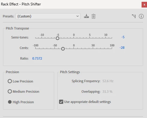

why is pitch shifter so bad?
It’s all in the title.
I’ve tried changing shift using audacity, here is the result :
https://vocaroo.com/1kMlby8qIrGz sounds fine to me.
Now, here is the result with audition :
https://vocaroo.com/1gv4P883Z3vI it’s absolute garbage
Why is there such a difference? I’ve made sure the “multitrack” frequency is the same as the file. I tried changing “stretch” settings to “rendered” (even though I didnt stretch it).
Here are my settings, I’ve tried to make them as close as audacity’s as possible :

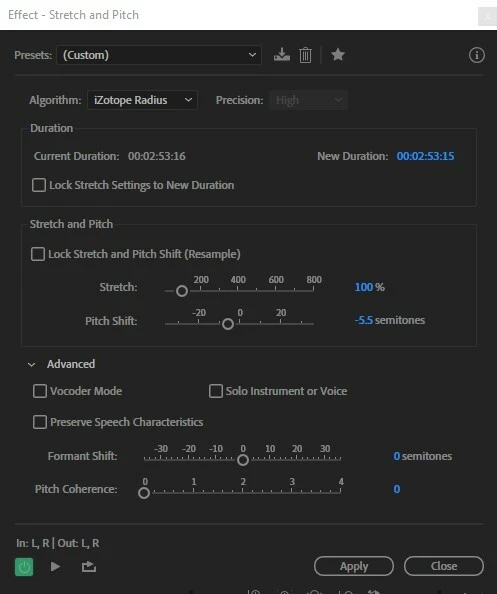

    Generally, using Stretch and Pitch works rather better, using the iZotope Radius algorithm - although the Stretch and Pitch option is not available in the Effects Rack; you have to use it standalone.
    5 replies

    I’m not sure how to do that, can you give me a little more pointers?

    Stretch and Pitch
    To shift just the pitch, set it up as the screenshot. You can put fractional amounts in the semitones box, and preview the result in the Preview editor before committing yourself to it.
