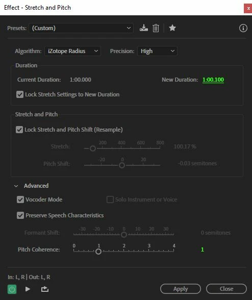

Firstly, yes there is. You can do this with Stretch and Pitch effect in Waveform view:
You have two choices when setting it up. If you know the time accurately, you can leave it just as the screengrab, only with the correct time inserted at the top. If you want to set it by pitch, then take out the check in the first section, which will un-grey the second one, where you can set the result by pitch. If you leave the check in the box to lock them, you'll achieve the result you want.
Secondly though, you've not got it quite correct; if you stretch a file in time, it will have the effect of it playing slower, not faster! (Think about it... 😉 )
