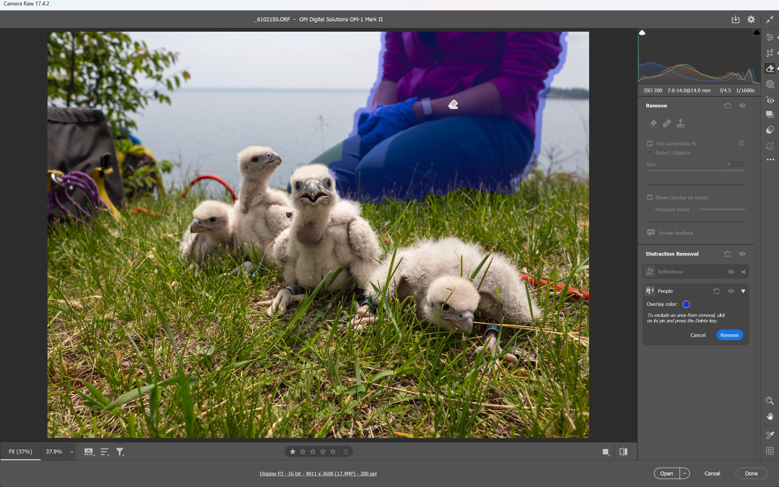

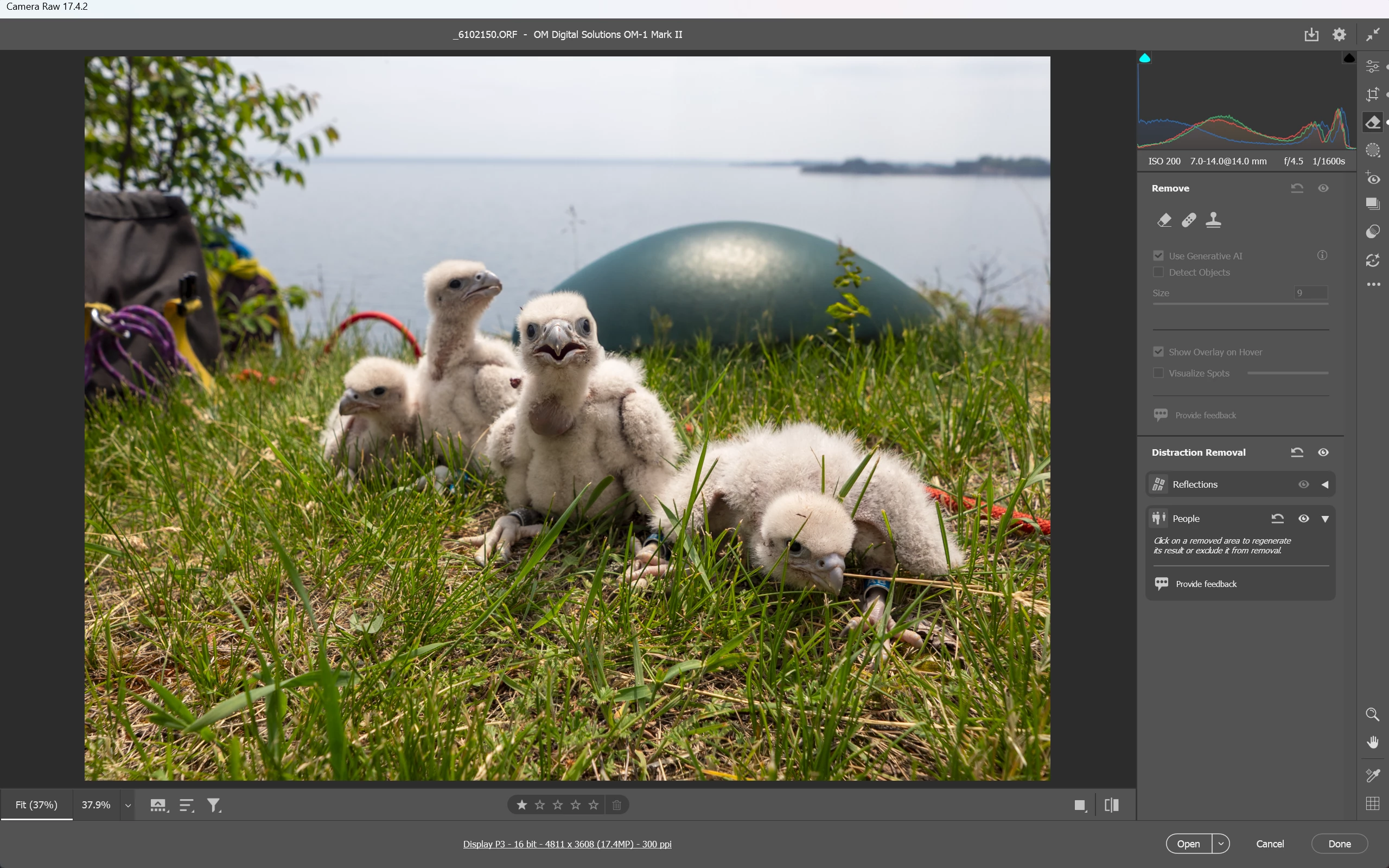

P: Distraction Removal: People (CR & LrClassic)
Announcing a new feature now in Adobe Camera Raw (17.2) – Removal of Distracting People
Under the Remove dialog, under Distraction Removal, we have added an item called “People”.
This feature supports faster and easier detection and removal of distracting people in an image. It is offered as a Tech Preview in the Adobe Camera Raw Plugin-only and is available now. Please try it out and let us know what works well, what doesn’t work well, and anything that might improve the experience.
Thank you!
