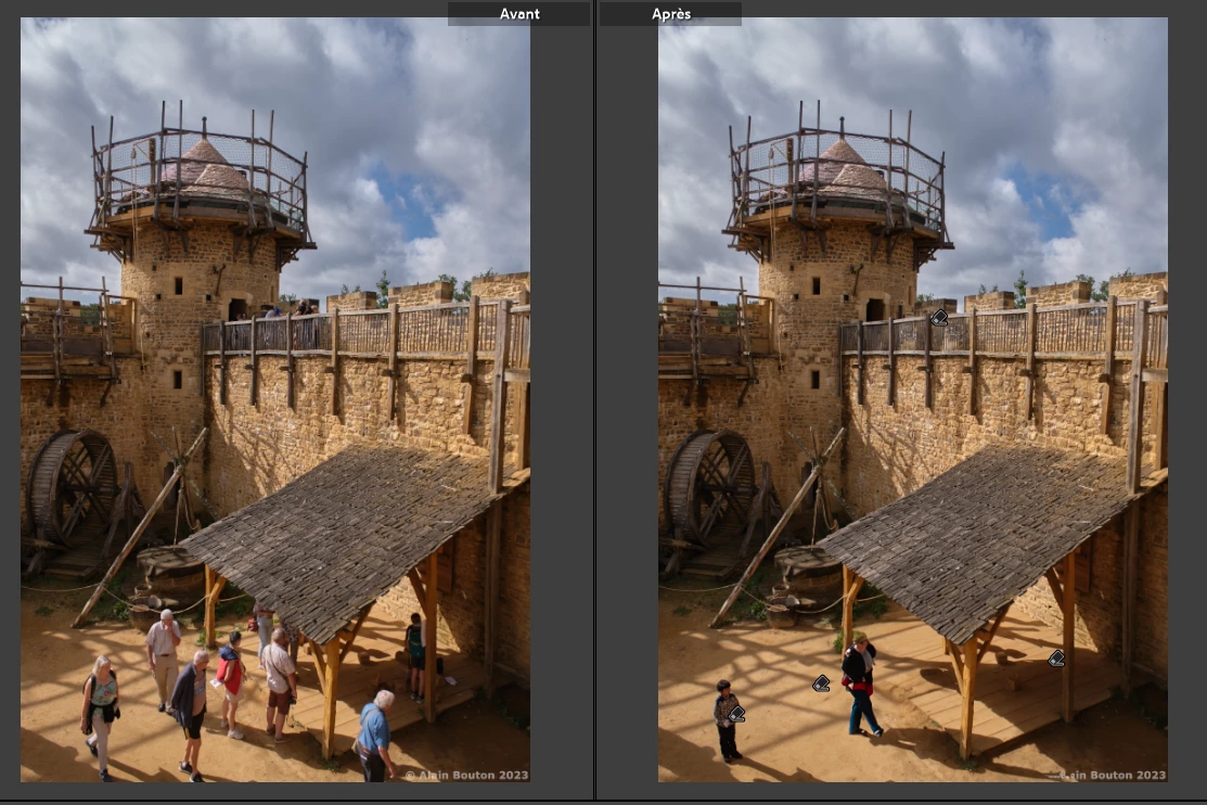

Aug 17, 2025 8:59 PM UTC
I'm getting this weird ghosting where elements (in this case people) has been removed.
