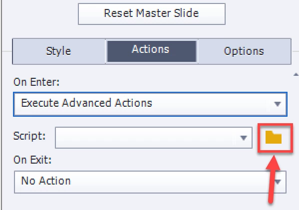

    Go to the first slide of content2, just after the last question slide of content1.
    In the Properties panel of the slide, go to the tab Actions. Open the dropdown list next to On Enter and choose Execute Advanced Action. Since you don't have one yet, there will be no list. Click on the Browser icon, it will open the Advanced Actions dialog box.

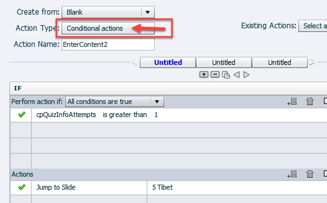

    Create this conditional action
    You have to replace the slide 'Tibet' by the first question slide of content 2

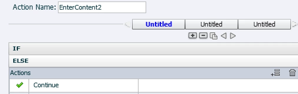

    Click on the Else button at the bottom and enter:
    Save that action (button at the bottom). Close the dialog box, the action will already be assigned to the On Enter event of the slide.

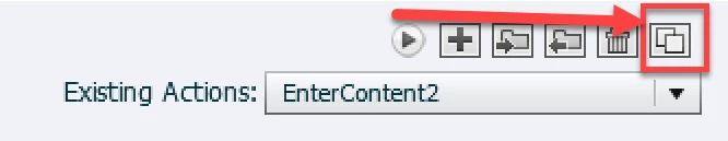

    You can duplicate the action (for content3) using the Duplicate button at the top:
    Edit this duplicate: name, and the slide to jump to (first  Save the action, close the dialog box.
