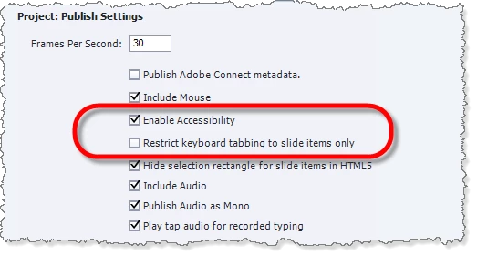

I just did a quick test of this with a SmartShape Button on slide executing a Standard Action that hides two text captions and shows another one.
I could not replicate your issue where tabbing to the button and hitting ENTER did not execute the action successfully.
Could you check your settings in Preferences to see if you have Enable Accessibility on?
Note that you can also restrict tabbing to the slide and not the playbar if necessary.

Yes I have that setting selected in my demo file.
There must be a setting somewhere I'm missing.
