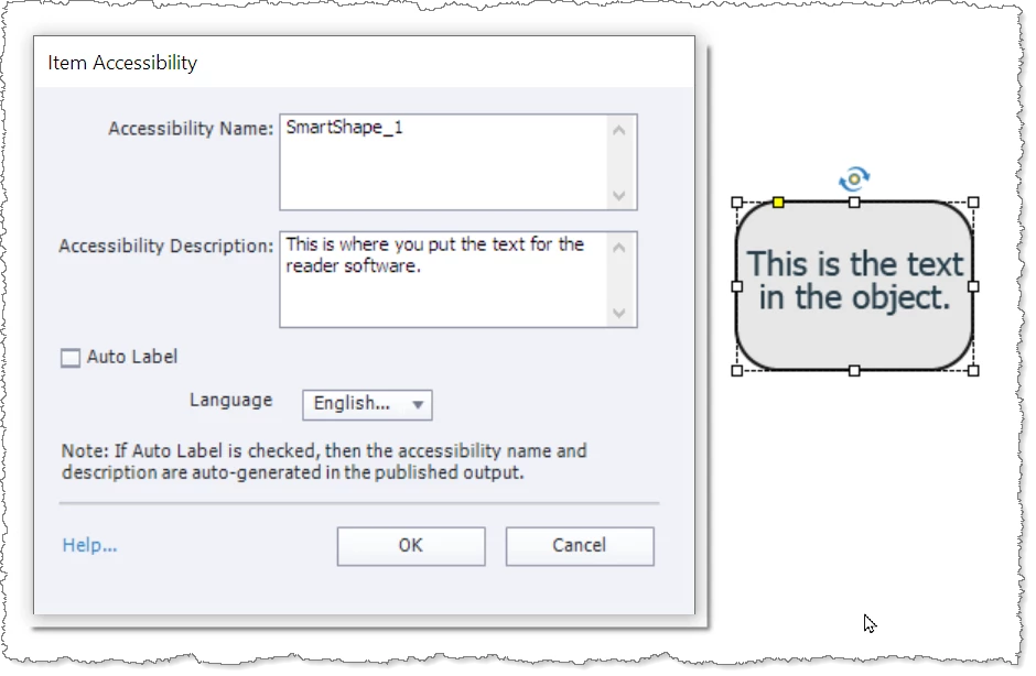

    That's exactly what happens and Captivate has done this from the time it was created.  On standard projects the text objects are converted into images when you publish.
    There is supposed to be a feature that automatically labels text objects according to the text they currently show.  But maybe you have that option turned off?

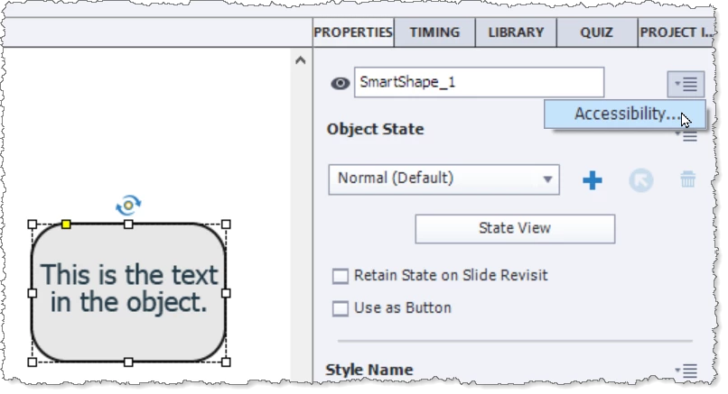

    The developer can insert accessible text for each slide object by selecting each item individually and then opening up the panel for Item Accessibility.
    Once the dialog is open you can enter the text.

    Thank you for the reply. We've checked this on multiple projects and have found that projects built on older versions of Captivate, such as Captivate 9, still work. In Microsft Edge for example, we can right click, and select 'Read-Aloud' and it will do so. However, anything built in the latest version of Captivate has nothing. The reader just doesn't work and is silent. It is not even picking up default objects like buttons.
    Thanks for your screenshots, I have just tried both methods of leaving auto-label checked and then unchecking and adding text manually. Both still do not work in a HTML5 preview.
    Any other ideas?
