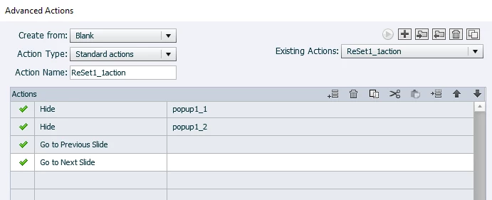

I'm using Captivate 9 and have inserted a D&D interaction. I want a reset to clear the board and hide popup answers.  I added this action to the reset button, but it just goes to the next slide:
What am I doing wrong?
Thx.

    if I remove the Go to Next Slide action, it will go to the previous slide just fine.  But when I put the two actions together, it just goes to the next slide after the D&D.

    Thanks Lilybiri, I have tried the dummy slide solution.  The only thing is i have a page counter widget, and that dummy slide impacts the total.  I did try that script you had in another solution, and it did work at one point, but now it doesn't. Is that Go to the Previous Slide, Go to the Next Slide not a viable alternative for me?
