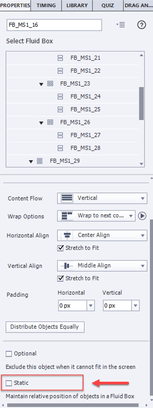

I suspect you have added a multi-state object in a fluid box. From the State View, you might want to add additional objects such as an image. You cannot have multiple objects in multi-state objects that are contained within fluid boxes unless you first convert that fluid box to a static fluid box.

It is just a checkbox in the Properties panel, to make the fluid box static. But it means you will lose the real fluiditiy of the fluid box. Make sure to check how that looks; when you use the play slider to watch it on different sscreen resolutionss.
Fill a shape with the image, you can add text to each shape. Play with the margins and the settings for the Fill to have the image and the text in the wanted  location. That is possible with one shape, and you can keep the normal fluid box. I explained that in my previous answer, maybe you missed it.

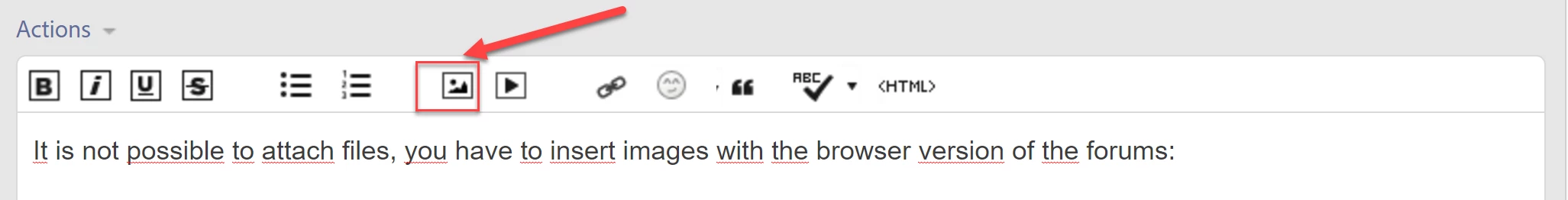

There is a big white space, but no screenshot, sorry.  You have to insert images using this button in the browser version of the forums:
