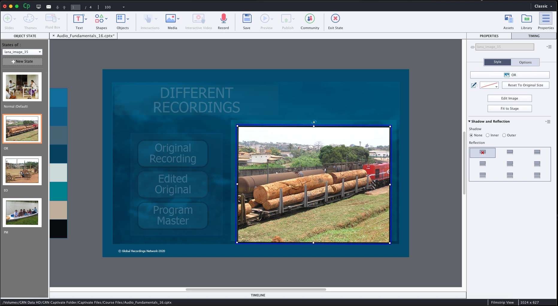

I am working on a module that has state view slides. On the slides I want the learner to be able to hear an audio file once they click on the button. Is this possible to do this in a state view? Here is a screen shot of my module. Thank you for any assistance.

It is not possible to add an interactive object to a state. You can add an audio clip to a state, but it will play when the state becomes visible.

Thank you so much. That is what I suspected, but am new to working with states. Will just add the audio and that should be fine.
