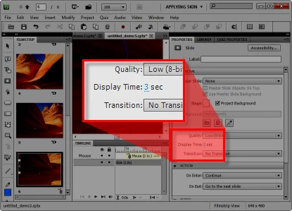

If you did Automatic recording, you do have slides, not a video. Have a look at the slides, probably the last ones and just delete those you do not want. Slide duration can be changed, but do not know it this is the solution you need: you can drag the end point of a slide in the Timeline, or adjust the length of a slide in the Properties panel, region General (look for Display time).
But since you are talking about 'coughing' I think you recorded audio at the same time as the screen capture (wouldn't recommend that personally, I'm always doing audio afterwards to concentrate on one thing at the time). You can edit audio on a slide, check the Audio menu.

You do this in a few different ways.
You can use the Slide properties dialog:
Or you may click and drag the end of the slide in the Timeline:
However, I'm guessing that neither of these will work for you. My guess is that you were recording audio simultaneously. This means your slide will have an audio file attached. To adjust the slide timing you will probably need to edit the audio clip and make it shorter.
Cheers... Rick
