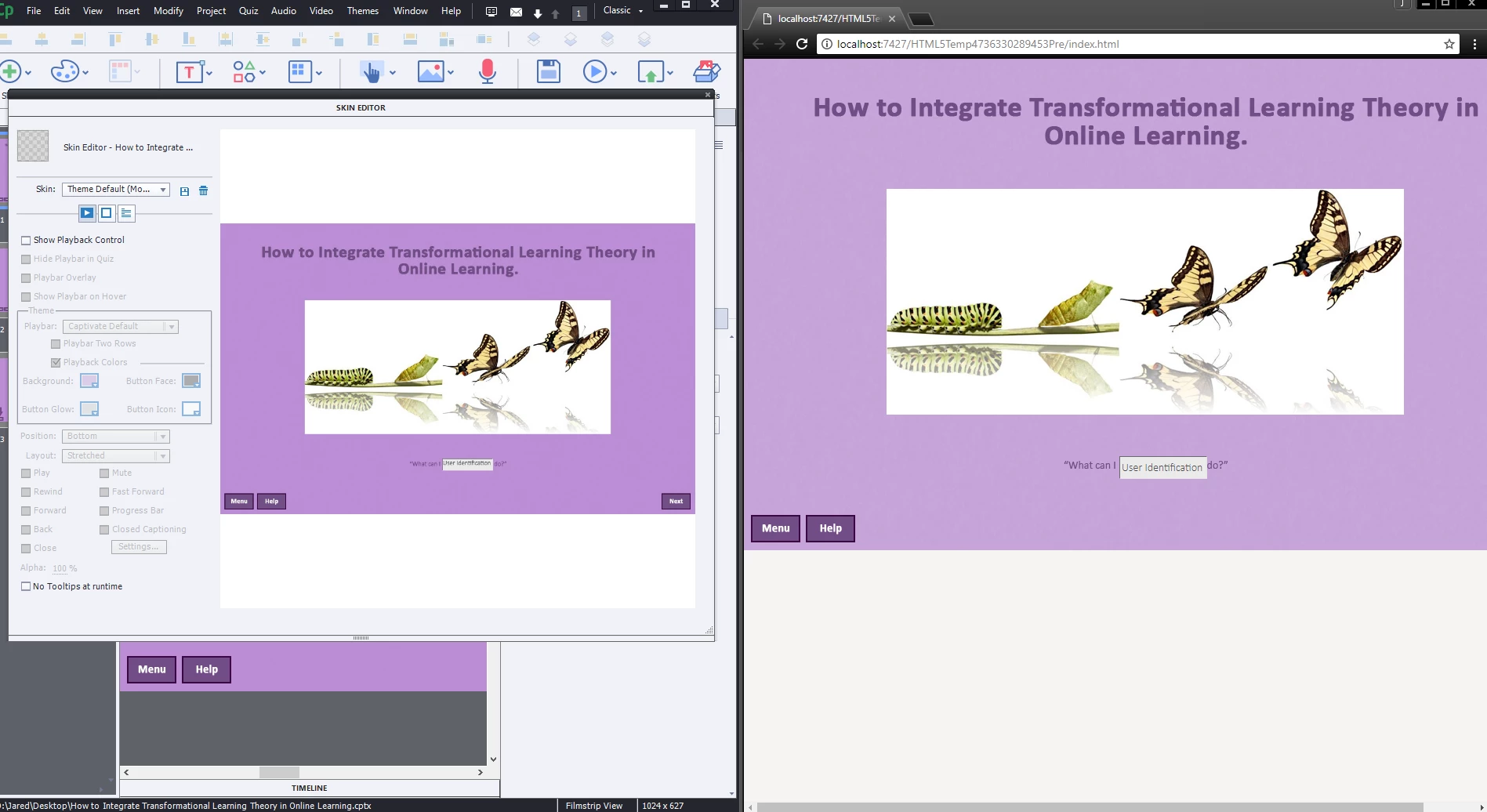

So I'm trying to make a small course as a part of a project for one of my classes, and I'm trying to have my navigation exist as onscreen buttons. I find that after unchecking "Show Playback Control" in the Skin Editor, my published version of the course completely breaks. So far I've worked around it by placing the playback controls on the top of the screen, disabling all buttons, and making the background the same color as the course. I don't want to have to use this workaround all the time though if there is a real fix to my problem.
This is what I see when I publish without playback controls:

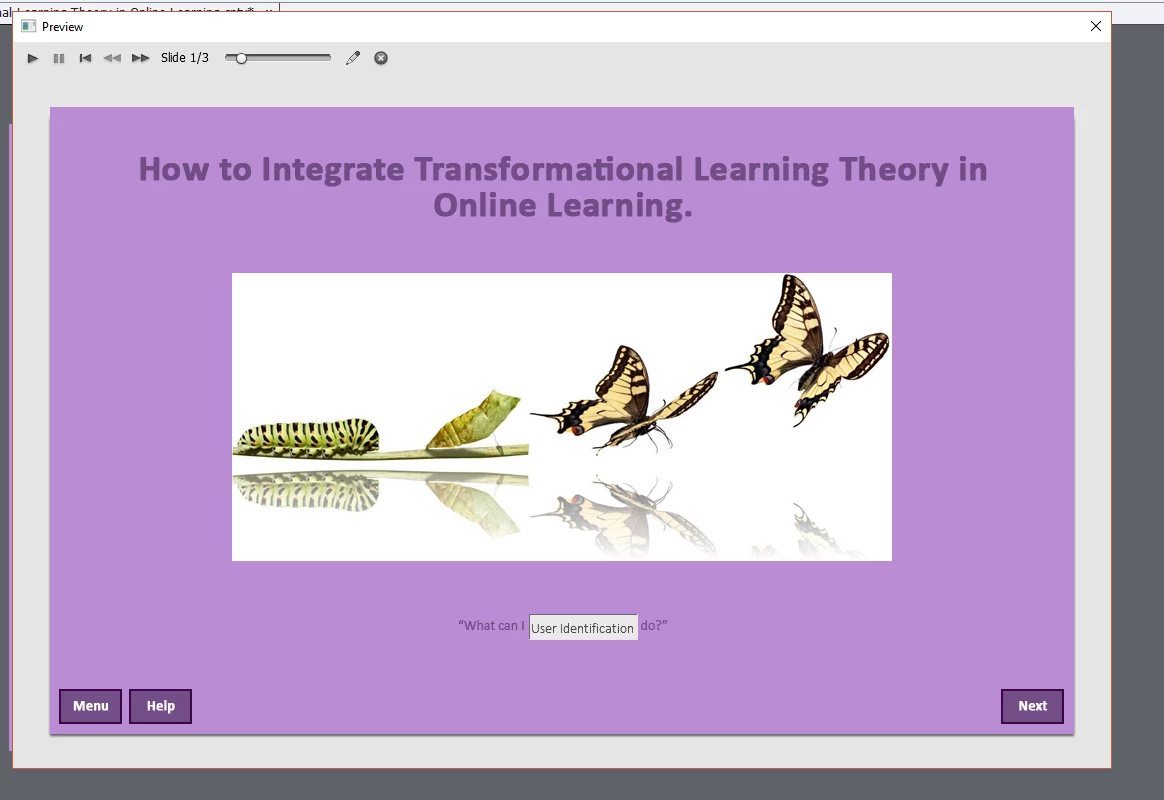

And this is what it looks like when I preview from within Captivate:
Does anyone know if there is a fix for this? I'm using Adobe Captivate 2017 10.0.0.192 and I've checked for updates from the help menu but it looks like I'm using the most up to date version.

    Hi Lilybiri, thanks for the quick response! Yeah I'm not sure what the actual root cause could be. I use Captivate at work and we generally don't use playbars but it seems to work fine (though I think we're using Captivate 9 at work, I got a free copy of Captivate 2017 from my school and I use it for my school projects). Yes, my project is non-responsive, I started from a blank project. And using F11 seemed to work with the playbar disabled:

    April 14, 2018
