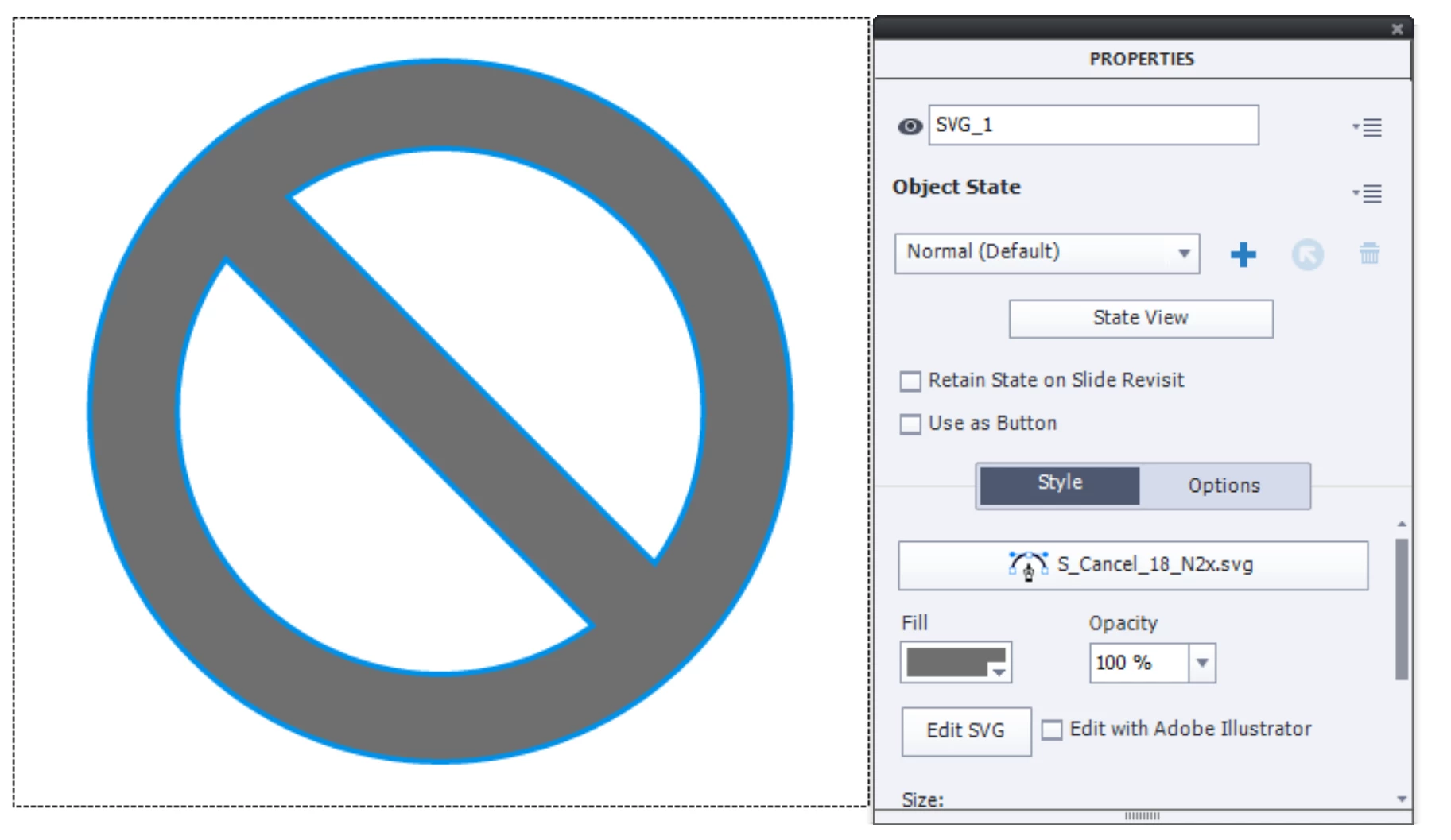

Nope. Like others, I "dobule click the SVG to place it in 'activation mode'" and the whole thing becomes white. Here I made two cancel icons from the assets panel, then double-cliked the right one:
Lilybiri
May 23, 2020 6:05 PM UTC
When you double-click, try to do in the fill, (black here). Eventually you may need a second single click.
The Fill will still not be available. Then click the fill again until you see a blue outline.
Do not become nervous, maybe your double-click is too hasty. It works, have been using this features many times. Not only for the game below.

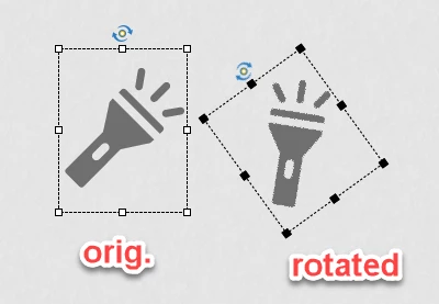

So now *I* am having this exact same problem, and also taking the specialist program (so that's where the instructions to double-click the svg to change colors. My fill is also the greyish background with red line from bottom-left to upper-right. I also had the (firewall?)/Assets Not Loading issue, so already did the https://community.adobe.com/t5/captivate/the-asset-panel-does-not-load-in-captivate-2019-release/m-p/10704741 instructions. Fixed the Assets problem, but two days later, there's this (same) .svg issue.
Could it be the .svg file supplied for the Speicalist program be funky for some reason?  [UPDATE: NOPE! - because the next exercise has you insert an ICON from the Assets library. And when you click or double-click on the icon to change the color of the icon, the same white(-only) box appears (again). Poo.
[UPDATE 2: I just rotated the icon I inserted manualy, and the outline(s) got all pixelated!

Because, now It's not just the .svg supplied by the Specialist program assets. But this also happens to Assetts => ICONs that are brought in through the assets panel.Went to assets- clicked on Icon - slected a flashlight - flashlight appears on stage - double-click the icon, and it goes totally WHITE. So it is not just the Specialist's .svg file, but appears to be ANY .svg file bring brought in. 😕😕

Lilybiri
Feb 6, 2020 10:31 PM UTC
Please insist. Click again and the paths will appear to allow you to change
the fill color.

Lilybiri
Feb 11, 2020 9:29 PM UTC
What does the Fill icon show in the Properties panel? The Icon assets of the Assets panel are simple closed paths. Up till now I didn't have any issues editing their Fill. But indeed, sometimes the double click shows a blank rectangle, clicking again makes paths visible and selectable. Do you zoom in on the SVG?
