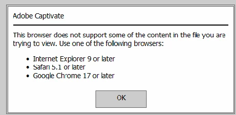

I have a problem  with adobe captivate 6 project HTML not running in IE 8.when i run it a window pop up the browser doesnot support the content.
How can i fix that and for your info I don't have the authority to upgrade the IE to later versions

    Captivate 6 was the first version to output HTML5 content.  However, IE8 is not HTML5 compliant.
    If IE8 is all you can use, instead of publishing to HTML5, publish to SWF/HTM.

    You CAN publish to SWF and use Right-Click.  Just make sure that you are not just trying to access the SWF directly.  You must use the JS and HTM files that Captivate publishes, and you must have at least one interactive object (e.g. click box) set up in your project to respond to a right-click AND you must have Accessibility turned OFF in Preferences.
