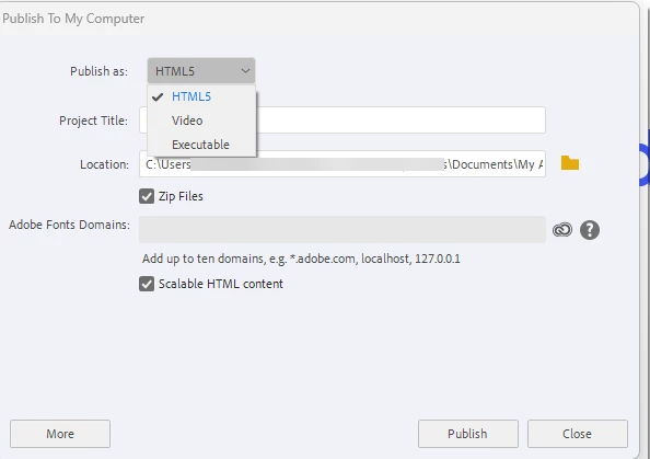

    I didn't zip and then SCORM. I published to HTML (because that's really the only viable option available) and checked "zip" from the publishing screen. Is there a differen't way I should be doing this?
