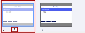

Mar 19, 2025 6:43 PM UTC
I appreciate the time you took to assist me, but I figured out the problem. Under Advanced Actions (F9) I found that there was a teeny tiny little clickbox that I couldn't see in one of the slide decks that had 'Include in Quiz' selected. I removed that box and now everything is working again.

Mar 19, 2025 6:37 PM UTC
Make sure Question 1 is not "hidden". Look in the pool to see if Question 1 is grayed-out and/or has a eye under like this:
