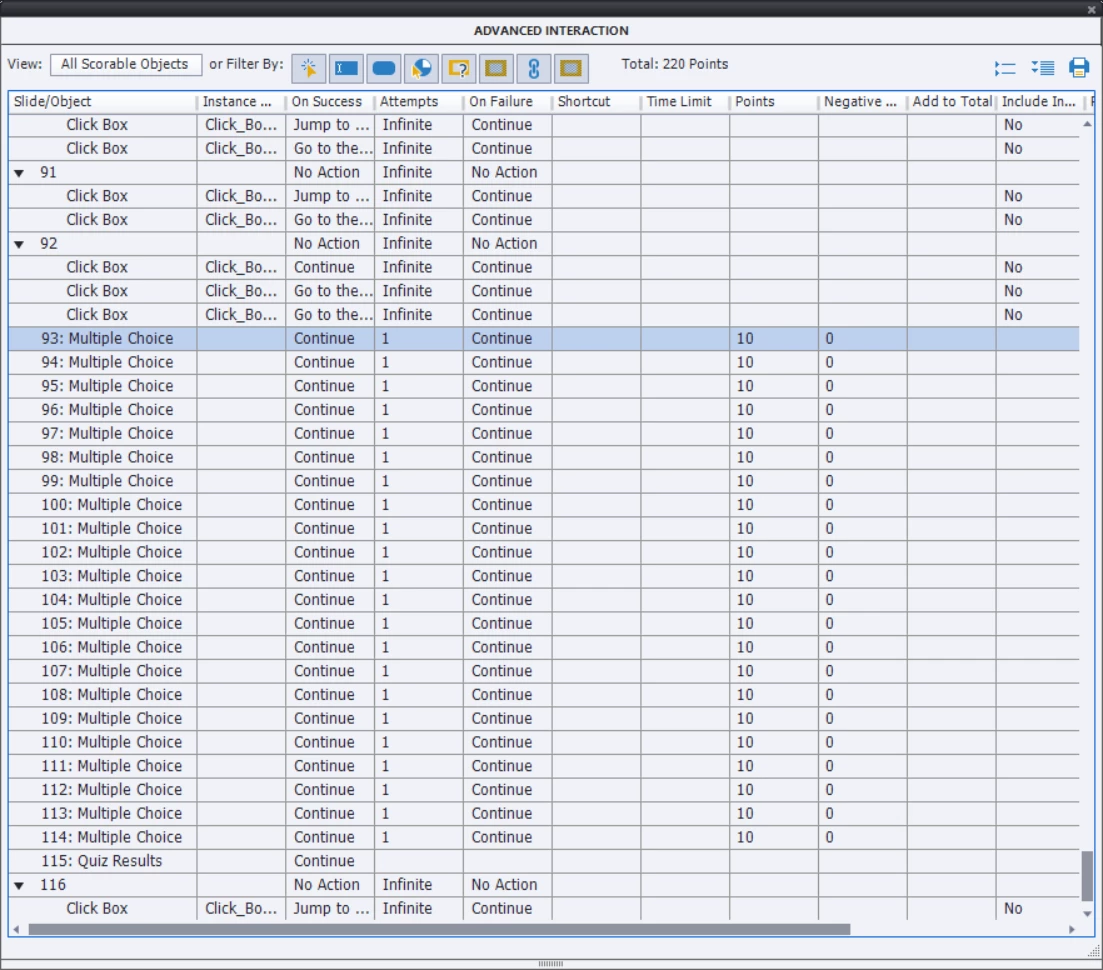

I am using Version 9.
So i have two quizes and one project
Quiz one has 10 questions
Quiz Two has 12 questions
Currently i have the quizes on there own projects separate to the learning material.
Each quiz requires you to pass at 80%
I want to combined the quiz however i want to ensure that the learner still has to obtain 80% out of the first 10 questions and 80% out of the second 12 questions in order to pass the overall quiz.
Does that make sense?

Beware: some LMS's do not support a total score over 100 points, you are at 220points. Is it necessary to have 10 points for each question? I suppose all are added to the Total score (column not visible).
It is a SCORM request to have only one score reported for each course, which will be the total score. THere are some tweaking possibilites:
  1. Show an intermeidate score slide (see Intermediate Score Slides - Captivate blog )
  2. Check the result on that intermediate score slide and tell the learner that they will not be able to succeed if they failes that subjject and send them immediately to the final score slide, where they can have a new attempt.
  3. Don't know if this is acceptable: but you could add a scored button at the end of the course, which only appears when they succeeded in all subjects, which adds a big amount of points to the total score to obtain the minimum 80% for the full course).

Sorry, but I don't understand your question completely. Could you also tell which version you are using?
By default Knowledge Check slides are never scored in Captivate, only real Quiz slides. I presume you talk about real quiz slides based on your question.
Can you show the Advanced Interaction panel (F9) and explain based on that panel what you want?
