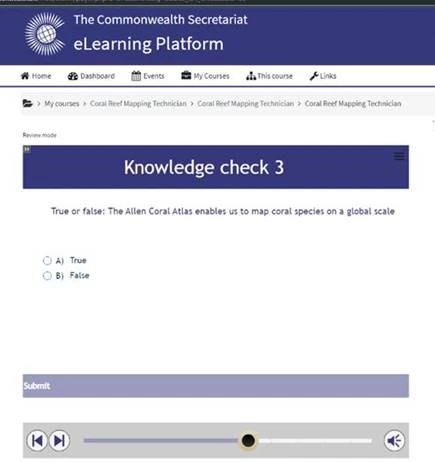

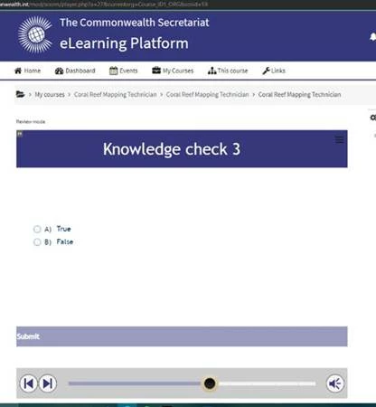

    I don't believe that I've deleted any embedded objects, though I have to say that the KC slide was being weird in Captivate in that as soon as it went from the master slide to the actual slide, the question text component unlocks itself from the fluid box and was impossible to get locked back in.
    I've popped an example of one of the slides below and how the question doesn't show up when first 'arriving' on the slide and then after going back and forward again, it magically re-appears. Again, not an issue on Chrome, just Edge it seems.
    Would love your thoughts!
