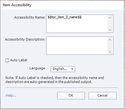

I would like to use a variable inside of the "Accessibility Title". This variable is updated every few slides to a new name, which is why I chose to store the text in a variable rather than hard-coding it. How can I apply this variable to the Accessibility Title? See image below for example. Any and all feedback is much appreciated. Thanks!

I have figured out that I can manually change the aria-label attribute using "Execute Javascript" in Advanced Actions. Still, it would be nice to not have to do this.
