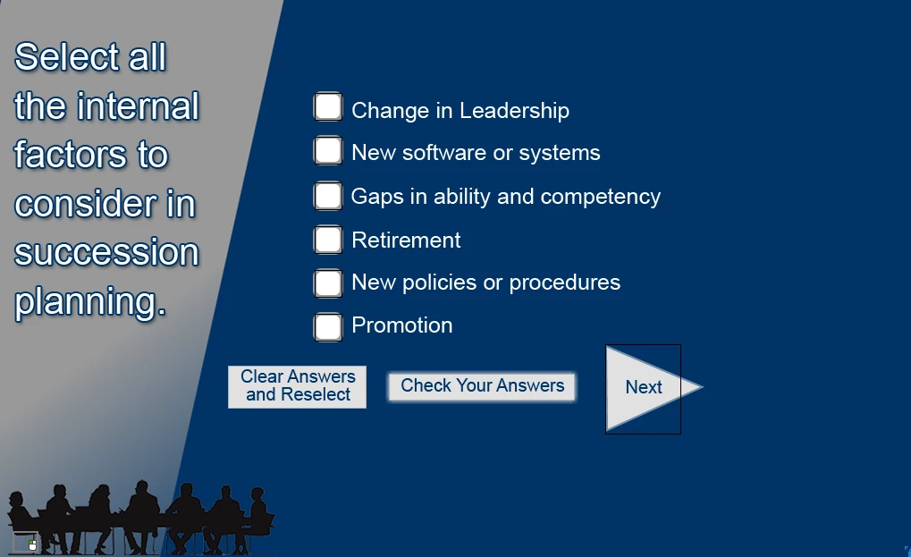

here's the screen for a multiple answer question - the next button is hidden until check answers is selected (clear answers is hidden at that point as well)
selecting a correct answer triggers this

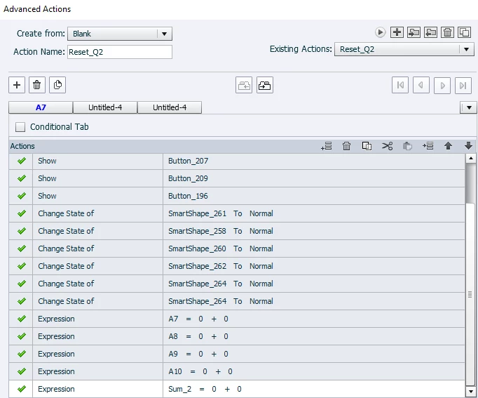

the advanced action for clear looks like this;
(I know the buttons over smart shapes seems redundant - but I am working in US government environment where 508 testing keeps failing smart shape buttons)

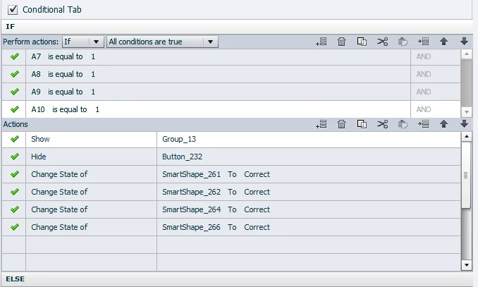

here's the check answer action
the weirdness begins when I preview in html5 in browser or publish to the LMS in html5 I get inconsistent execution of the clear/reset action, one or more of the buttons will fail to reappear and the stage will not reset to normal. clicking on other answers and selecting clear again will result in a different button or buttons failing to reset.

Sorry, needs too much guessing. No desriptions in the Shared action, why do you define 1 as parameter? Where are the buttons, where are the shapes?  Are they both interactive or not? In that case the problem is with having two interactive objets in the same location, not possible in HTML5 output.
Please show the timeline, with a button selected/
Most recent version is 11.0.1.266, you forgot to install the patch release months ago.
