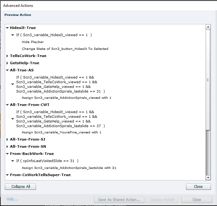

I am working on a scenario that can result in viewing the same slide from different branches. The navigation part of the scenario (and the actions) works well. The only part that isn't working is colouring visited buttons. Here is a sketch of what happens:
.1 User visits Source #1 (BackWork) and clicks a button (Scn3_button_AddictionSpirals).
.2 User visits the common slide (AddictionSpirals) which has a few buttons that lead to end points. On entry to that slide, conditionals check:
.a If a viewed variable (Scn3_variable_HidesIt_viewed) is equal to 1, the relevant button is set to a "visited" colour. There is a conditional for each button on this slide and the viewed variables are set correctly, and they are being correctly detected, and the buttons are correctly coloured.
.b If all the buttons have been viewed and the last slide (Scn3_variable_AddictionSpirals_lastslide) is the right source (in this example it's Slide 31), the variable for the button on AddictionSpirals (Scn3_variable_AddictionSpirals_viewed) is set to 1. There is a copy of this conditional for each possible source button.
.3 After the user views all the content on AddictionSpirals (visits all the buttons), if they return to the source (BackWork), the original button (Scn3_button_AddictionSpirals) is coloured correctly (as all the content below it in the tree has been viewed). So, the first time through, all works correctly. The trick is if the user continues to another source.
.4 User visits another source (YoureFine), enters the common slide (AddictionSpirals), and sees that all of the content below this point has already been viewed. When they enter this slide, a conditional should fire that says:
Have all buttons been viewed AND the last slide is YoureFine? Then set viewed variable (Scn3_variable_YoureFine_viewed) to 1.
.5 When the user returns to the source (YoureFine), the button (Scn3_button_YoureFine) does not colour correctly. This only happens the SECOND time the user visits the common slide (AdditionSpirals), AND if they view AddictionSpirals again and return to the source, Scn3_button_YoureFine colours correctly.
Debugging: I have the variables outputting on AddictionSpirals, and they all have the correct values, so the problem lies with the conditional not evaluating correctly. At least, that's what it seems to be.

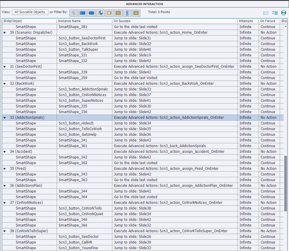

As requested:
Lilybiri
September 18, 2019
Too complicated to understand only textual explanation.
Please post a Preview of the advanced action! And of the Advanced Interaction panel.
mattb80613184
September 18, 2019
Images added as requested
