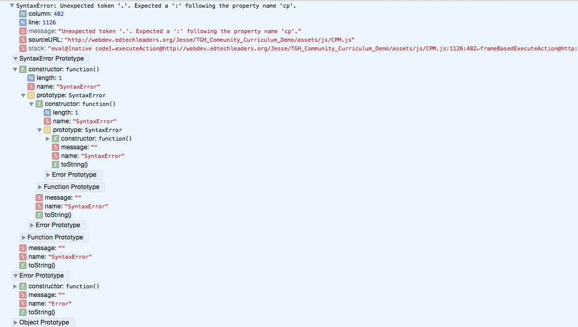

December 21, 2015
Hey Jord,
Thanks for the tip! I've attached a section of the error console as a screenshot. It seems there are a bunch of errors occurring. Am I to understand that I can edit the project.txt file to fix these? Or is this code "living" somewhere else? When I open that file in a text editor it only exists on Line 1 and makes it near impossible to find the points at which I need to correct.
Thank you so much for pointing out the idea of using the browser's console. (The error below is probably appearing due to an Advanced Action to show images of stars for completion of a section of the course I am developing).

Jordster1
December 21, 2015
Hmmm...for it to not like the '.' dot notation after the object reference 'cp' (which is altogether incredibly common) I feel like maybe there's a syntax error in a code window somewhere that's throwing off the eval of the native calls, making it think that 'cp' variable is a key to a data value instead of an object/function reference. Basically, the actual cause of the error might not be with this call itself but something that cascaded until it hit this point.
Double-check your Actions, make sure there isn't an errant JS execution somewhere, and that all the variables you're using in actions still exist in the variables table. Maybe something was deleted but an Action wasn't updated? Captivate has shown a disconnect sometimes for me between when I update scripts and what it shows in preview. I'll be CERTAIN I changed something and yet when I inspect the script from the preview location its from hours previous. Somewhere around the forum is a thread about deleting Captivate's cache, I would definitely try that as well and republish/repreview the project, inspecting the console while interacting and see if you can get the errors to pop up in the preview window.
