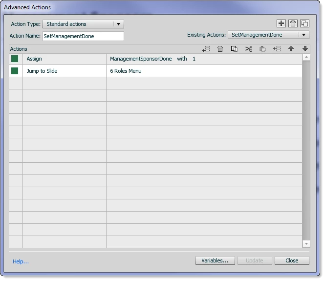

Here's what a typical action looked like:
As you can see, when the learner is exiting the role information slide, and it executes this action, it sets the ManagementSponsorDone variable to 1 and then jumps back to the Roles Menu slide (the slide with all the role photos).

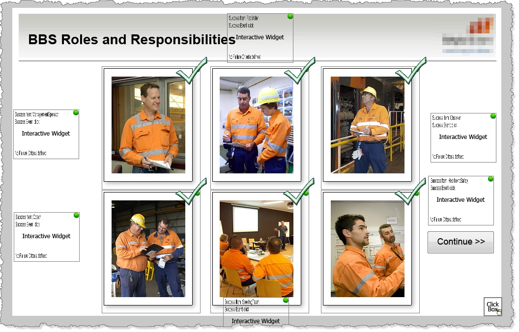

Here's what the menu slide looks like. Each tick has an Item Name that indicates which role it applies to (ManagerTick, etc):

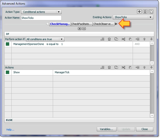

And here's what the ShowTicks conditional action looks like:
Note the arrow here that shows how the conditional action is made up of one condition for each role.
