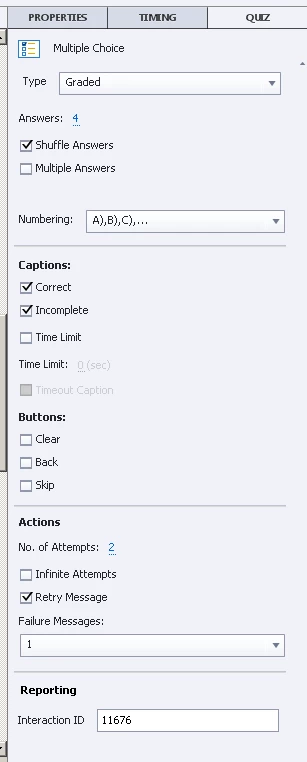

I'm using Captivate 2017 and would like to try Advanced Answer, however, it is not showing for MCQ with Single Answer.
This is the only option showing when I select any of the answers whether it is correct or incorrect.
Thanks in advance!

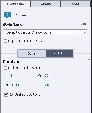

    Correct answer Paul Wilson CTDP
    The key is that you need to select your answer or one of your distractors before going to the Properties/Options area. Here is a video I created on this. I hope it helps you. Adobe Captivate - Different Feedback for Each Answer - YouTube

    Paul Wilson CTDPCommunity ExpertCorrect answer
    September 5, 2018

    lisl_cammileg14411995
    September 5, 2018
    Hi Paul,
    I watched your video earlier today and that's why I wanted to try the Advanced action. I think I got it figured out now, the advanced answer is only available for knowledge check slides which I overlook.

    Paul Wilson CTDP
    September 5, 2018
    You can use it on final quiz questions as well. You just need to select the answer you're working with first and it can only be for single answer questions. Multiple Choice where you can select more than one answer isn't compatible with an advanced answer either.
