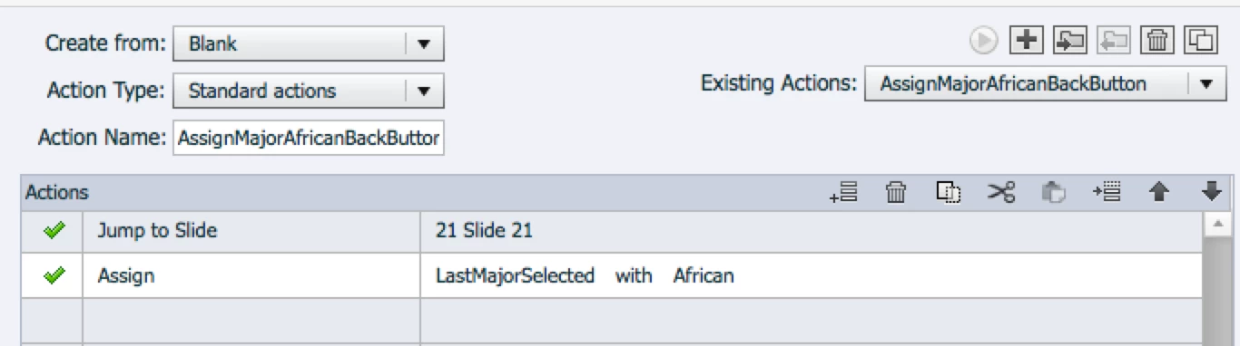

I am hoping someone can help. I have a Captivate 9 project in which students view certain slides and then these slides' Back buttons use an advanced action to assign a literal to a variable called LastMajorSelected (in addition to returning to the slide from where they came).

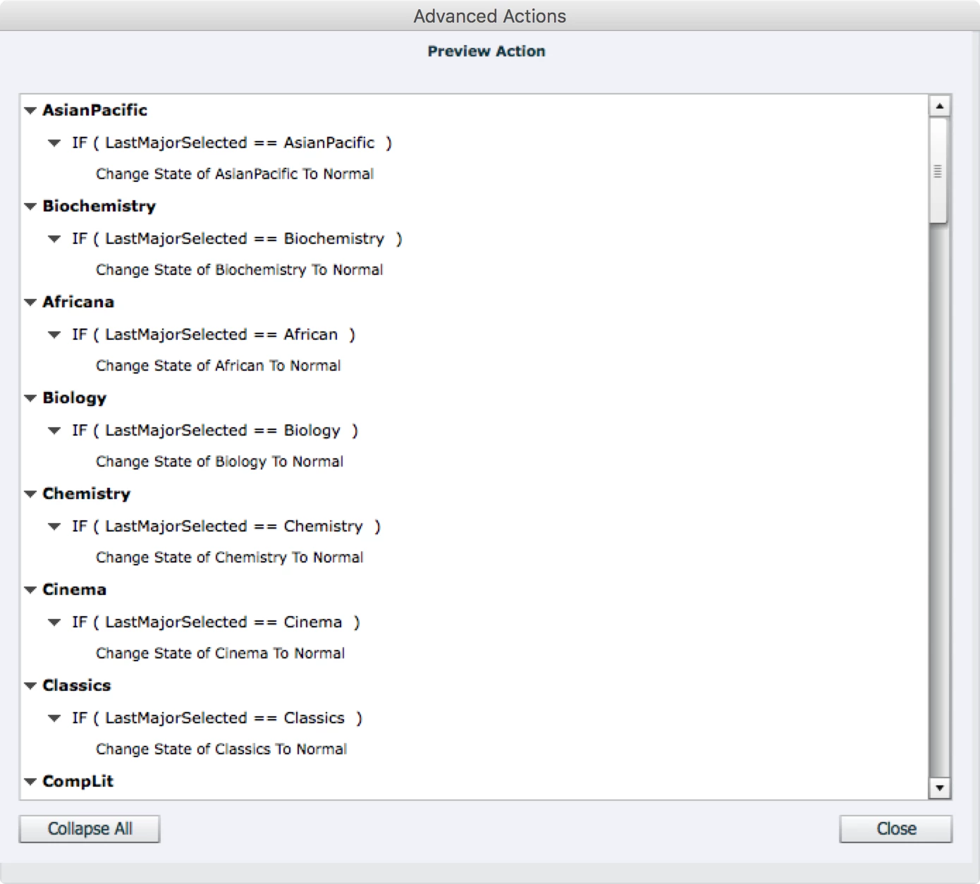

Following this logic, the final value of LastMajorSelected is checked in a separate Advanced Action which should cause the state of a "hidden" image object to change to "Normal." You will probably notice that each of these checks are separated into distinct decisions:
However, when the student gets to that slide the Advanced Action does nothing. It is needed to display the last chart (in miniature) that a student viewed on another slide ( they need to reference it). At any rate, I am including a screenshot of the actions as well as the timeline of the slide where the advanced action is run in case something there is causing an issue. You can see from that timeline that there are a lot of images there (and they are hidden on top of one another). This is unavoidable as there are 46 majors to choose from and none can be omitted, and also they need to display in a certain area of the slide.

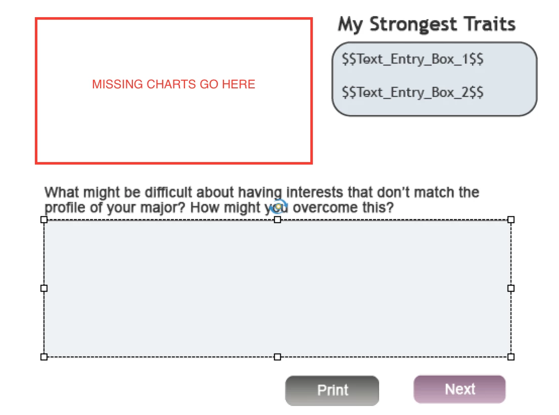

Here is a screenshot of the slide where the charts should display indicating where it should be if it's state was changed to Normal successfully:
