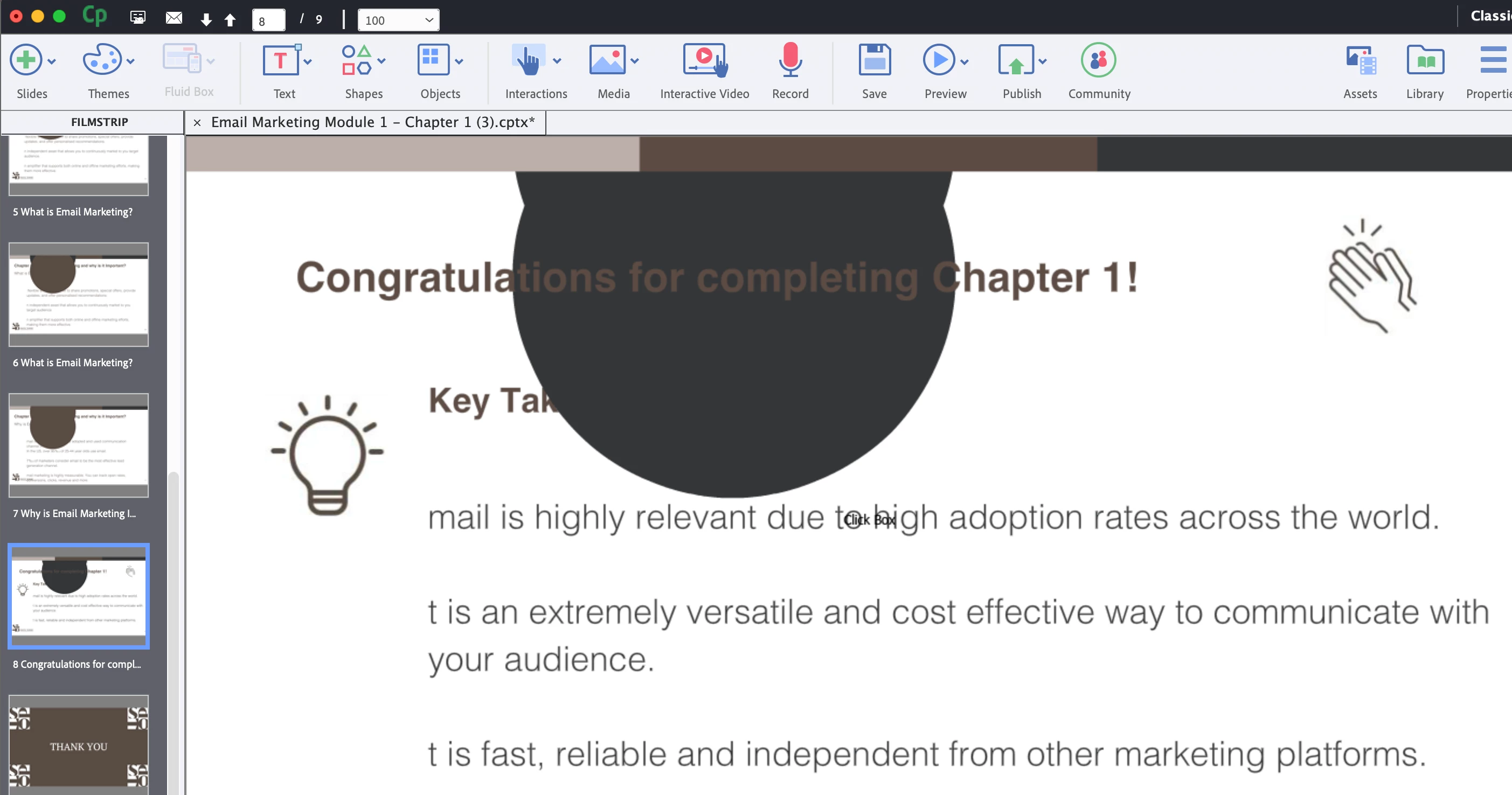

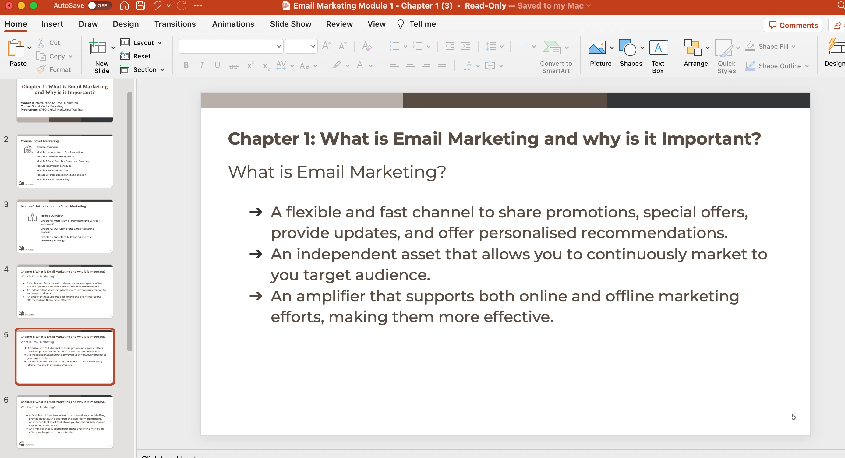

I'm very new to Captivate. I am trying to import PPTX slides that I made into AC.

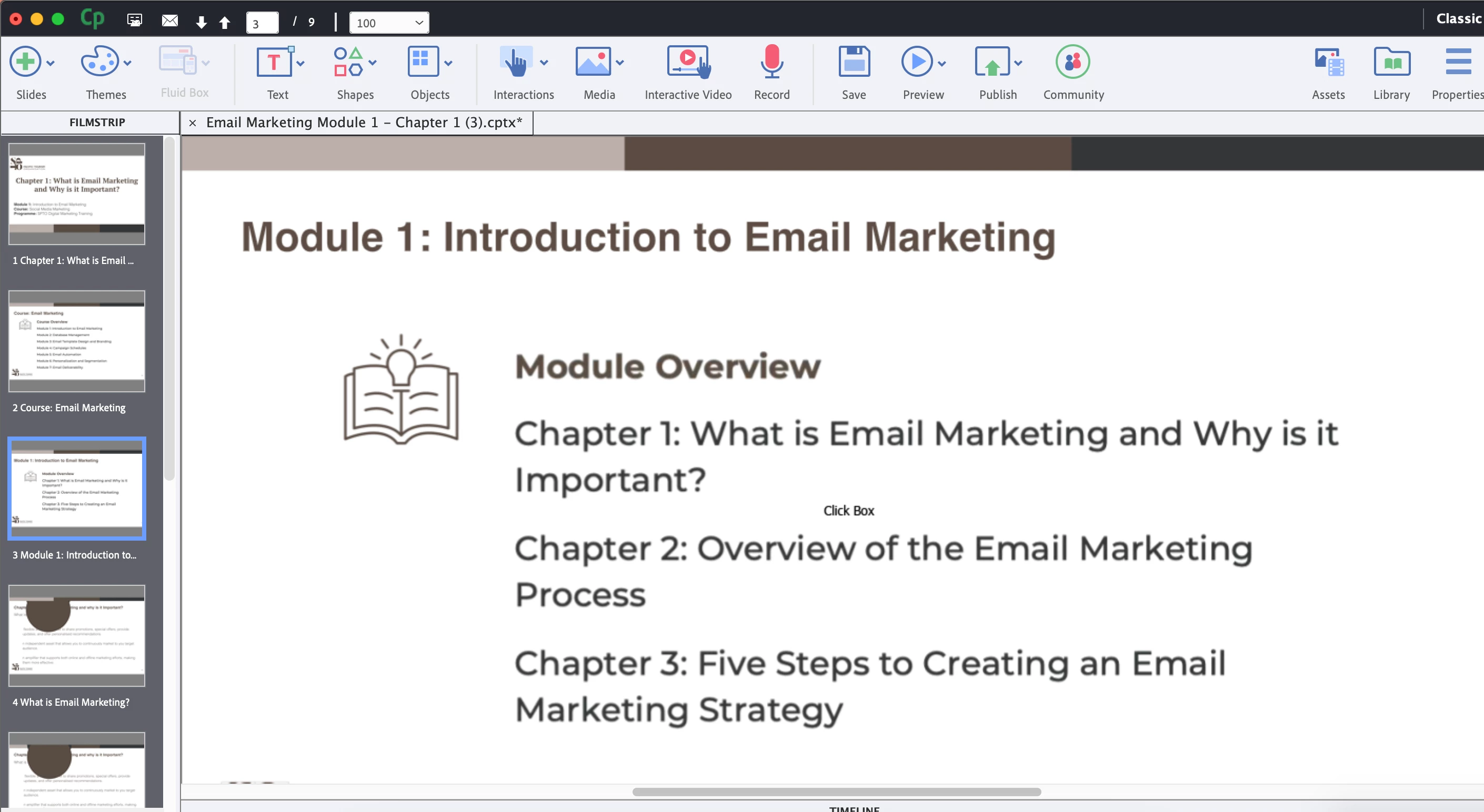

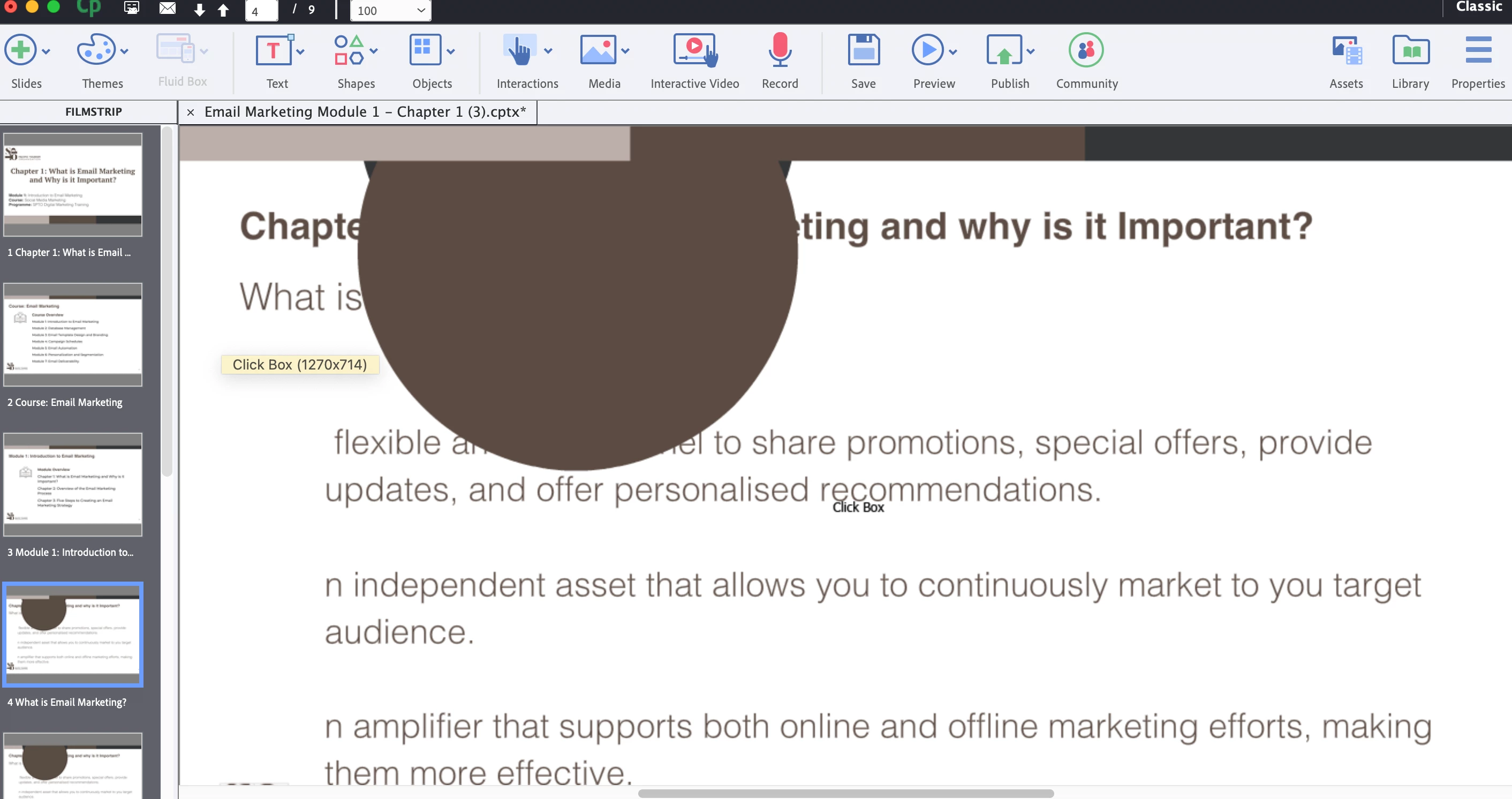

The first 3 slides look fine after import, but the last 4 get corrupted. They have huge circles covering the slide and I don't know how to fix this issue.
I tried copying and then reworking the slides that import fine, but as soon as I change the content, the slide gets corrupted in the same way.
I tried changing the style of bullet points to see if that does anything, but that also did not helo.

It looks like you may have added one or more shape objects (the big brown circles) to one of the slides, or to one of the master slides that form the Theme.
I suggest you first inspect the Master Slides to see if you can find the offending shapes there.  If you can, then change the affected slides to a different (preferably blank) master slide.
If you cannot find the shape on any Master Slide then it may be on one of the normal slides but set to be timed for Rest of Project.  Either way, to get rid of it you have to find the slide that contains the offending shape and then remove it.

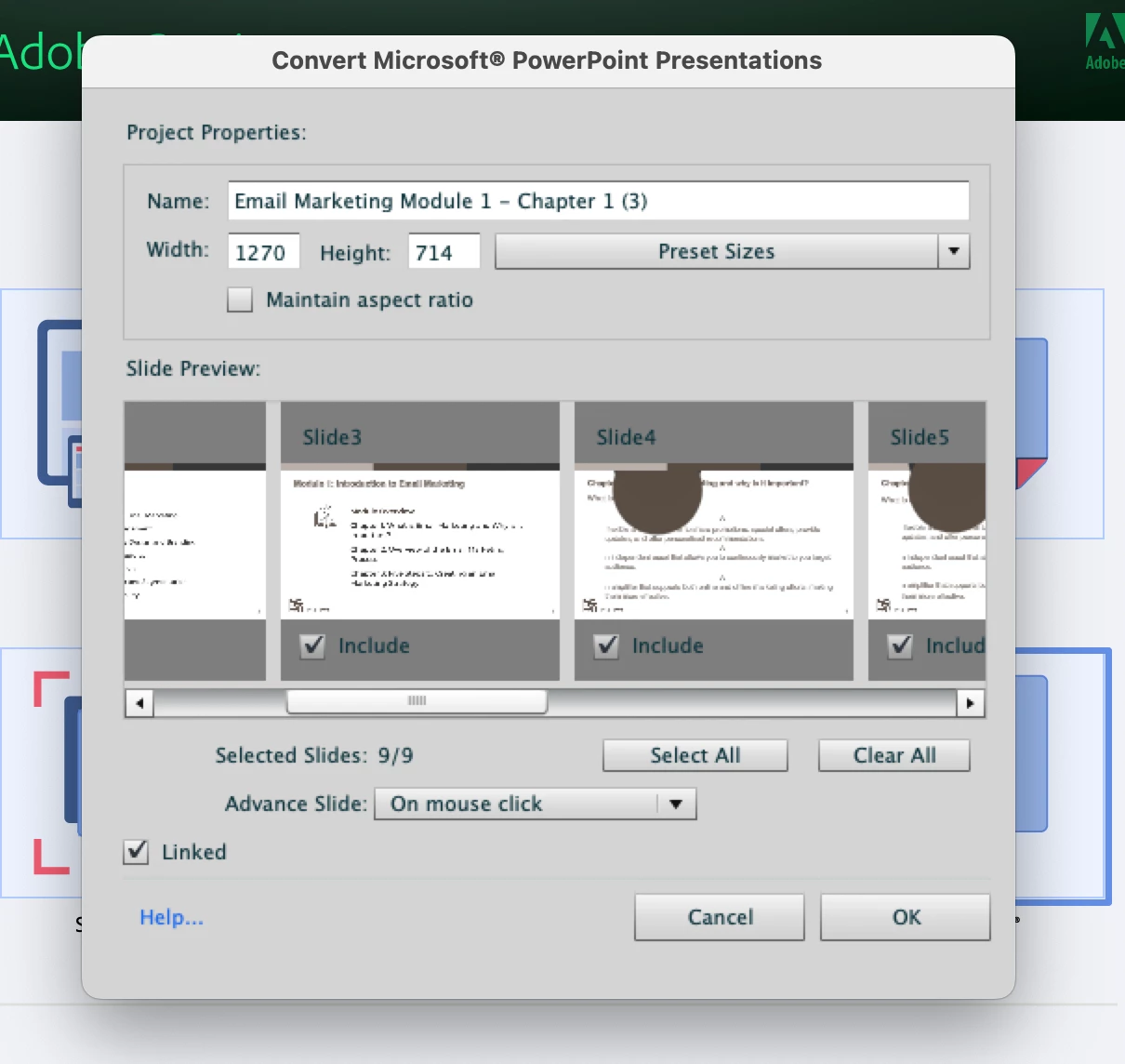

I had a look at the screenshots but don't see what you want to explain by them. I would for sure check the feature 'Maintain aspect ratio' in the Import dialog box, because differences in size are for sure one of the problems with importing a PPT.
