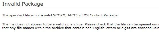

I created 10 individual projects which I then aggregated.
No problems with uploading each individual project/file onto our LMS but when I aggregated them all together into the one file and tried to upload I got the invalid package message (see below):
Any tips would be appreciated.
PS     The LMS I'm using is Enterprise Knowledge Platform by NetDimensions.
July 3, 2010
Hi melbmary,
The error message suggests it's a problem with the way the files have been zipped up. Did you zip them up using Captivate or a separate tool?
Feel free to send me a copy of the package at robert(dot)lowe(at)netdimensions(dot)com and I will take a look.

melbmaryAuthor
July 9, 2010
Thanks for the offer of help Robert,
I finally figured out how the Captivate 4 SCORM packager works and loaded the file onto our LMS.
(I was uploading a zip file published with Captivate Aggregator rather than compiling individual zip files with Captivate SCORM packager.)
