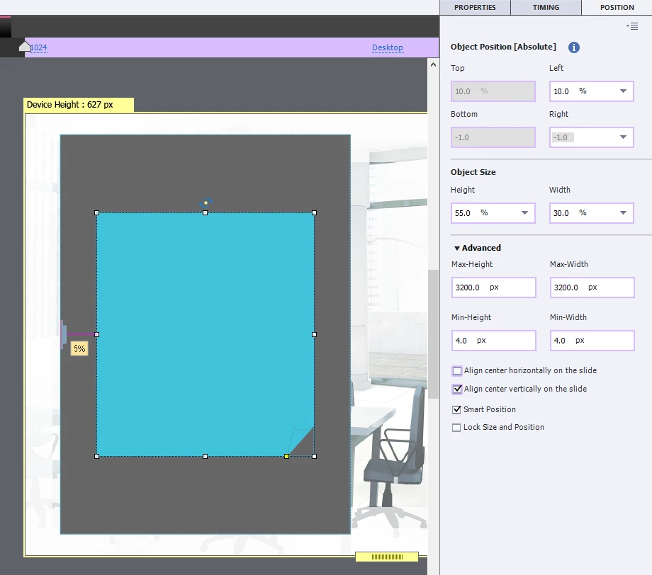

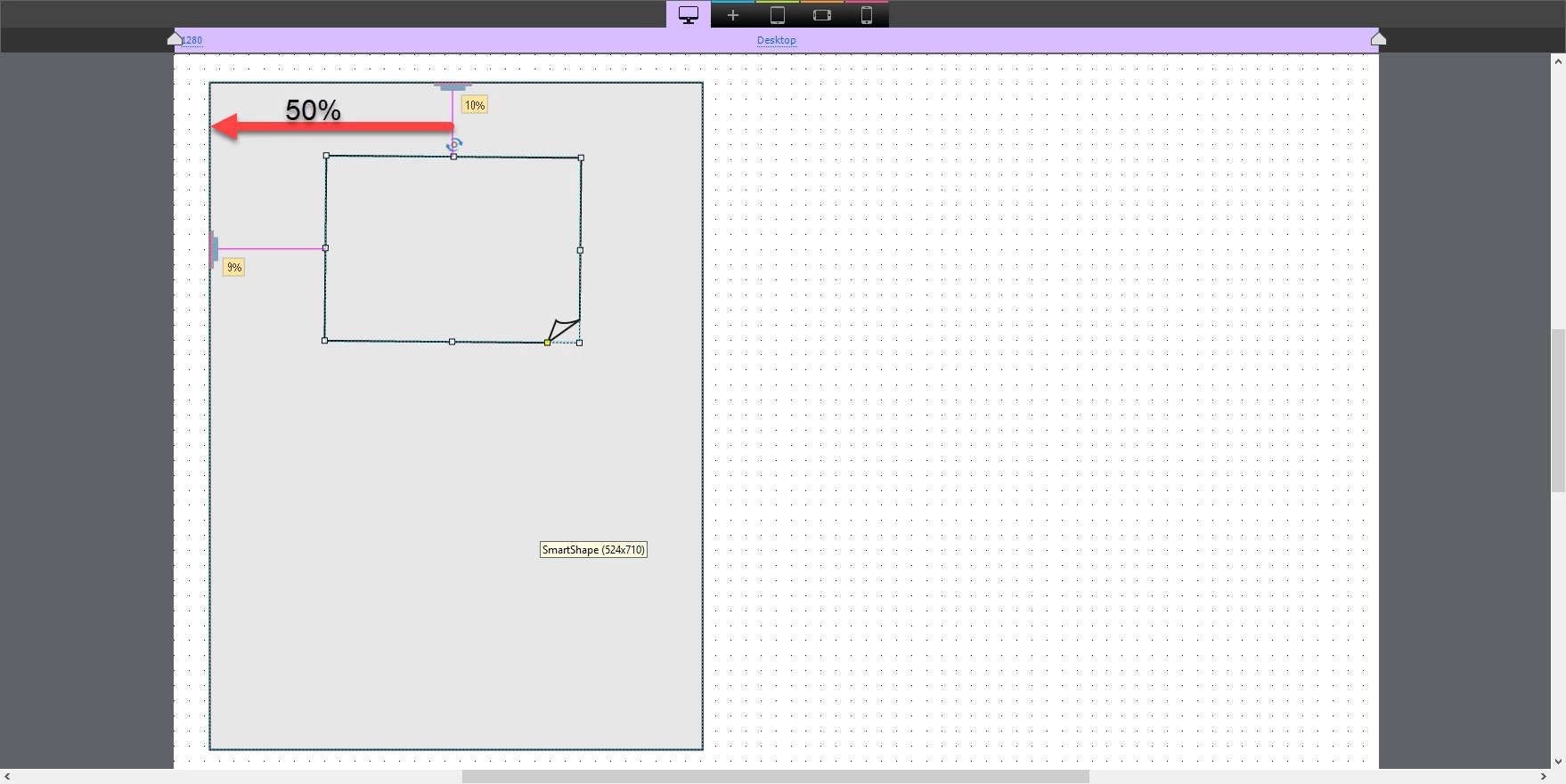

    Try this (just an example)...
    Create your background shape with a height of 90% and check Align Center vertically on the slide. Make the width 40% and have it 5% from the left (this will leave 5% between the object and the actual center of the slide.
    Place your foreground object on top and use Smart Position to Anchor it to the left side of the other image. Make the width 30 % and set it to be 10% from the side (5 % from the left of the other object). Set the height to be something less than the 90 % you selected for the lower shape, say 50%. If you stick with % values it should size nicely from breakpoint to breakpoint and in between.

    HI Paul,
    I see what you mean, you use the % dimensions of the objects and spaces around it to accomplice the desired alignment. I will try this for the next days and I think I can use it that way.
