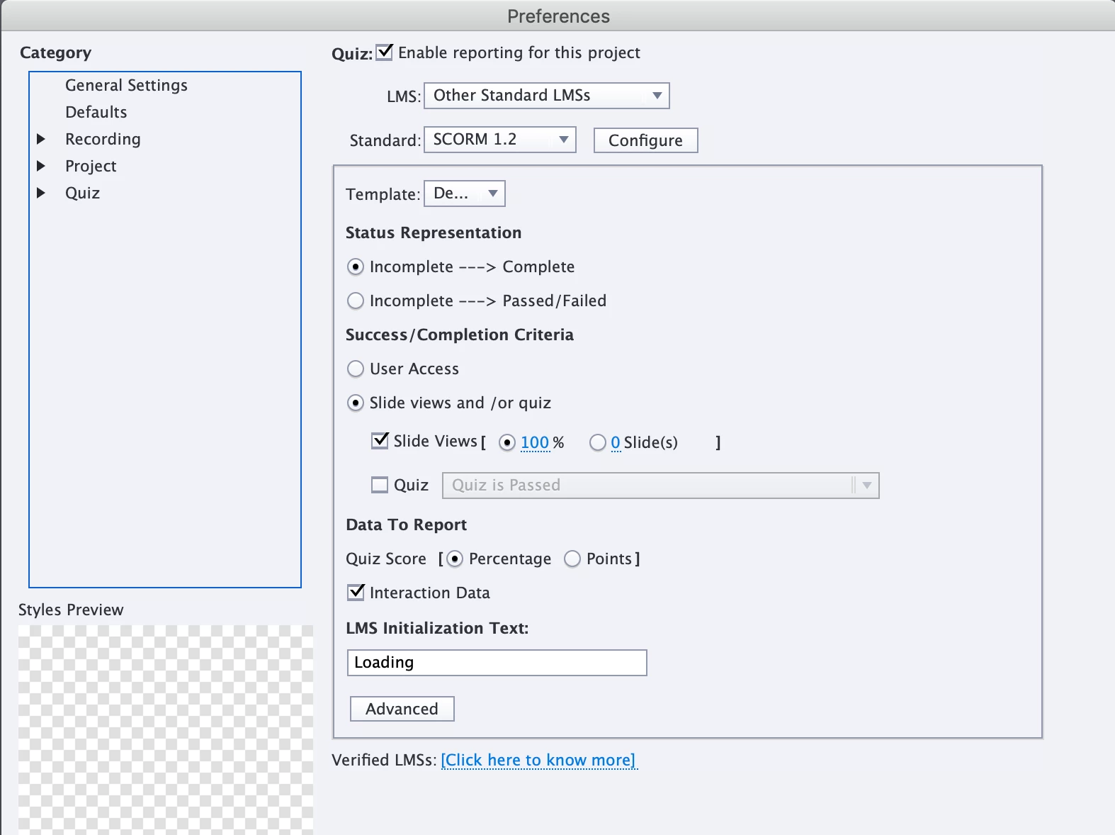

I have a couple of issues with captivate program on my macOS Mojave (10.14.6):

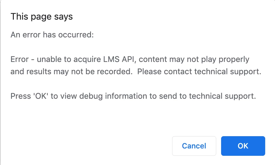

1. My client wants something simple with mobile responsive - Just read each slides, watch videos, and tick the box after they have read the policies before go on next slide etc. When I published, open the file and pop up says "An error has occurred: Error - unable to acquire LMS API. content may not play properly and results may not be recorded. Please contact technical support."

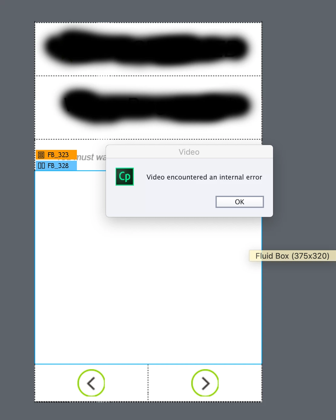

2. When I test the slides, YouTube appear working just fine but when I publish the LMS and youtube didn't appear.
I hope anyone can help me with these issues.

If you configure a project as a SCORM and then test it locally (not by uploading to an LMS) then you will see the Error about being unable to acquire the LMS API.  That's just telling you that it can't detect any LMS to talk to because you don't have one loaded on your local system.  Upload the same SCORM to SCORM Cloud and then it would be happy.

Thanks for respond to my post. Make sense about error about unable to acquire the LMS API.

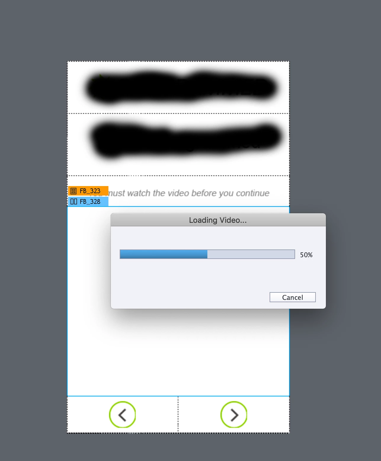

YouTube videos are under my client's user and all videos are public. I tried other way with vimeo and doesn't work - When I upload the url link and been stuck loading half way for half hour. Do you have any suggestion for straming video provider or other way around?
