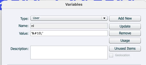

    If you want it to work within an Advance Action....then create a new variable called anything you wish, I will call it nl for t this demo.....assign your new variable with the following text: '&#10;'
    Example:
    Now when you are wanting to add new lines to your strings, use the new variable you created and it will work like a charm!
    Example: v_teb_notes = "Hello" + nl + "world";

    I then added the nl variable in Captivate, specifying the expression "v_teb_notes=v_teb_notes+nl" on my loading slide so that when the TEB displays the user should see the text "Initial thoughts" (the default value of v_teb_notes is "Initial thoughts") with the cursor on line 2 ready to accept input. The TEB displays "Initial thoughts'&#10;'" so CP is  appending the nl value rather than interpreting it as a new line.
    I then tried using the nl variable in the JS expression in place of the escape codes and this allowed the script to run successfully. However, the line breaks where not displayed in the TEB, only the literal characters i.e. '&#10;'
    This made me wonder if there is an issue with the TEB, so I added a text caption that displays v_teb_notes. With '&#10;' as the value the line breaks are added but with '' between the strings, so I changed the value to &#10;
    This displays correctly in the text caption but not in the TEB. The TEB appears to ignore the escaped line break.
