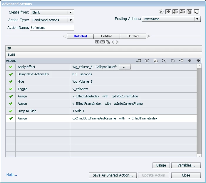

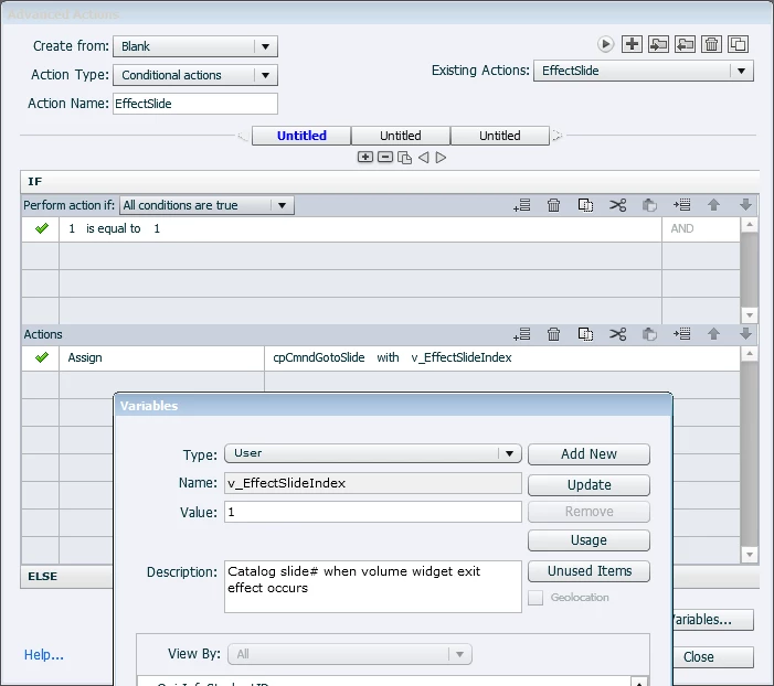

First, add a blank slide to the project. I chose to put it as slide#1, with all my rest-of-project buttons on it but nothing else, and set the OnEnter action to what you see in the screenshot below. Having that slide in 1st also obviates the need for an expression in the GoToSlide command line below; a simple Assign does the trick. Created 2 user variables at the same time, 1 to track the frame# when the AA executes (value left blank), and the other to track the slide# with the value set to 1 so that it skips straight to the 2nd slide upon opening the project.

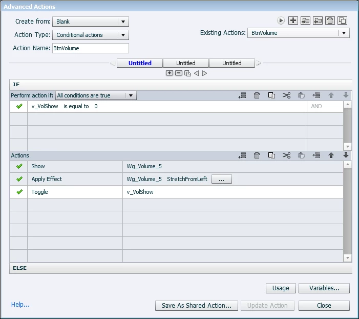

Then created this AA and attached to my volume button. The stretch and collapse effects each have a 0.3 sec duration.
Hopefully this or some adaptation of it works out for you. Good luck.

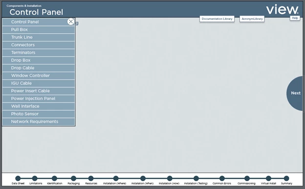

Here is the stage with the custom TOC showing (including the close button/but the open button is no longer visible)

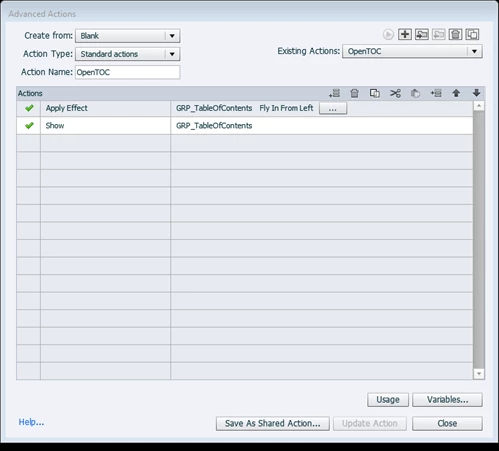

Here is the open advanced action - which works as is, and I can reopen the menu immediately after closing written as is:

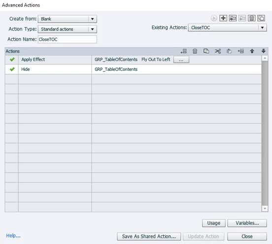

And here's the problem close advanced action. When I remove the apply effect, I can reopen the menu immediately. If I include the apply effect, I can't seem to reopen the menu.
Both apply effects are set for .5 sec.
