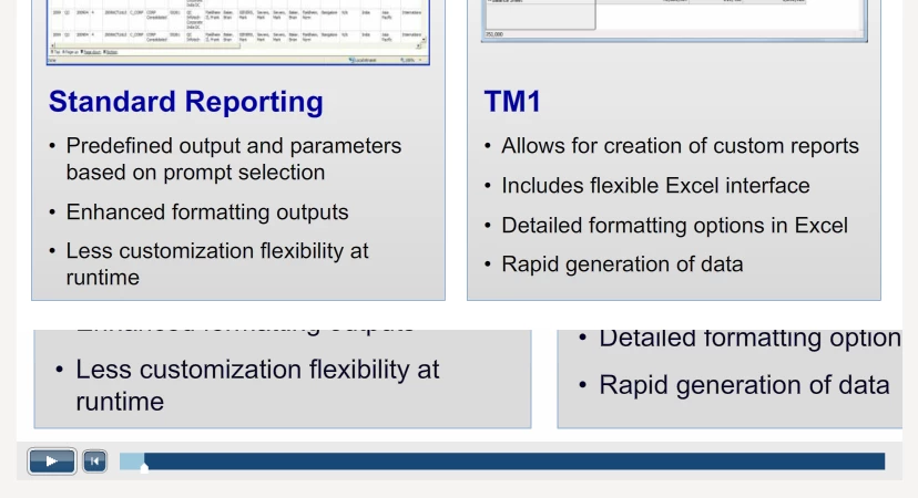

Hi all,
I have a CP file created from a PPTX. Once the slides have been imported, I rescaled the project (maintaining aspect ratio) to shrink it, then resized it again (NOT maintaining aspect ratio) to add some blank space below my slides for additional content. All is well within CP, but once I publish it to SWF, artifacts (looks like the same slide content at original size) appear at the bottom where my blank space is supposed to be. (See partial screenshot below.) Any thoughts on why this is happening? Or if there's a better way to put my PPT slides in a CP file at specified dimensions AND have blank space at the bottom, I'm certainly open to other ways of doing it.
Thanks!
J
(Windows 7, Captivate 6 64-bit, PowerPoint 2010)

Lilybiri, thanks for your response. I have tried all different slide qualities settings, and have had the same issue. The issue isn't really related to quality of the slide content, it's content showing where there's not supposed to be content. I have seen your knockout master slide post, but it doesn't quite apply to my case, as I need the blank space on some slides in order to add text boxes within CP. I suppose I could apply the master slide to only those without text boxes. I guess I was mainly curious as to whether the issue I'm having was a result of something I'm doing wrong, or a bug. I'm convinced it's a bug with CP.

SethXP, I realize that it would be ideal to have the dimensions of the source files match your final output as much as possible. Resizing the PPT causes alignment issues that I do not have time to fix. Since CP has the rescale option (it's the first option under Modify, so I assume it's a relatively popular function), I assumed that resizing slides within CP is something I should be able to do without much grief, and that is not turning out to be the case. However, thank you for the link, that will be very helpful in the future.
