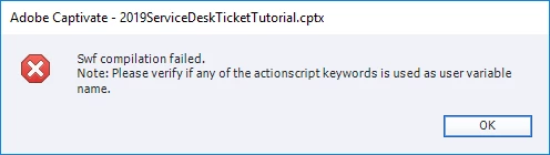

At my wits end! adobe captivate 2019 Swf compilation failed. Note: Please verify if any of the actionscript keywords is used as user variable name
I keep getting this error code when I am trying to publish projects.  I am trying to publish in video format.  I have copied and pasted the slides into a blank project and received the same error.
My computer was upgraded to Windows 10 and Captivate 2019.  I used to be on Captivate 8.  After the upgrade that is when all of this started.
Thanks in advance for suggestions.

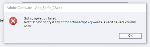

May 23, 2019 5:51 PM UTC
I'm getting this same issue. I got a new laptop yesterday and installed Captivate on it. Opened the same project I've been working on, made no changes and tried to generate a video. This worked yesterday on my old laptop with the exact same version of Captivate 2019 and Windows 10 and today, on my new laptop, it gives me the "Swf compilation failed..." issue. There is nothing wrong with the file because it worked on my old machine and haven't added any extraneous characters or anything.
May 23, 2019 5:52 PM UTC
I also opened a new file, put nothing in it and tried publishing a blank 1 slide project and got the same issue.

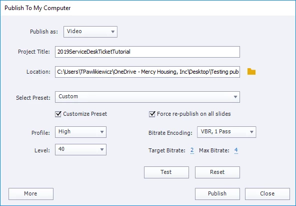

trishpawAuthor
Feb 28, 2019 3:36 PM UTC
Thank you both for your responses.
I have a screenshot below to show you that it is indeed giving me this error when I try to publish a video.  It published in HTML5 it works.  Please see below screenshots of when I am publishing in Video format.
I have also tried copying and pasting all slides into a new project and it does the same.
Again, thank you for the suggestions.

RodWard
Feb 28, 2019 4:16 PM UTC
OK. I see what you mean.  The publishing process is basically first publishing an SWF and then probably creating the video frames from the SWF frames.
Either way the same issue is going to recur if there is some corruption or issue on any of the slides.  If you cannot get the project to publish to SWF, then it's never going to get to MP4 after that.
I still think the way to debug this is to try hiding groups of slides and then again trying to publish to SWF to find out if you can publish without those slides being involved.
The other thing I would do is NOT set my publish folder to be a ONE Drive folder.  Point to a normal folder somewhere on your C drive, preferably close to root level.  The publishing issue could be that you are publishing to a drive that is closely related to a cloud service.
