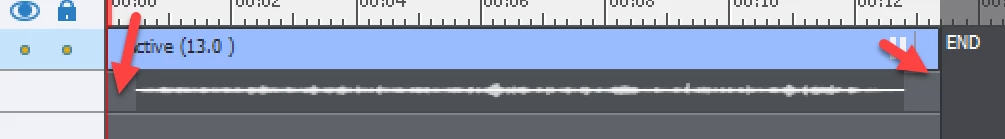

I would recommend to leave a small gap before and after the slide audio in each side:
Mar 6, 2018 7:05 PM UTC
I've tried that,
unfortunately didn't seem to do anything with the slides it keeps happening on.
Thanks  anyway
