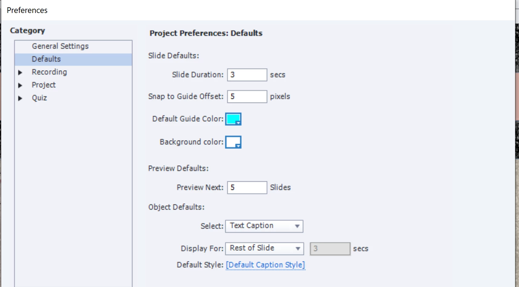

    • When installing Captivate you can set Global Preferences (from the Welcome screen). One of the changes I always do is under Defaults, Object Defaults, Display For. By default it is set to 3 seconds for each type of object, but I change it to Rest of slide, since that is the option I use most. That will avoid the manual editing you did have to do. BTW you can also select multiple objects (I use the Timeline for that) and set their timing under the Timing Properties to 'Rest of slide' if you already created the objects. The shortcut key which I always use for that purpose is CTRL-E, avoids the need to open the Timing panel.
