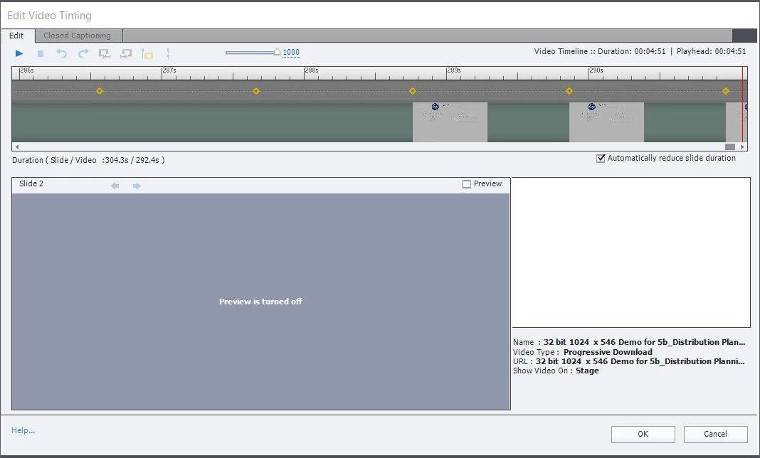

On occasion I have had the video duration shortened in the slide inadvertently by myself or by a bug in the app. (Can't say for sure which). This created the TTS cut off at the end of the slide as you described.
I stumbled on the fix for this by looking at the Edit Video Timing window and increasing the zoom to 1000 which allowed me to see a lightened area at the end of the timeline. I was then able to drag the end marker a few milliseconds to the end of the timeline in the Edit Video Timing window and resolve the narration cut off problem.
This happened to me when  using a single slide with event video inserted. (Not video across multiple slides)
Hope this helps.

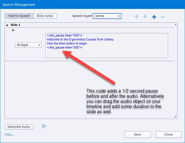

My practice with the Neospeech agents and the text you enter for each line of text is to add a pause of about 500 milliseconds. Here is an example of how I begin and end my text to speech narration.
Paul Wilson, CTDP

I had been using the audio track in the timeline and adding a half second by hand and that didn't solve the problem.
