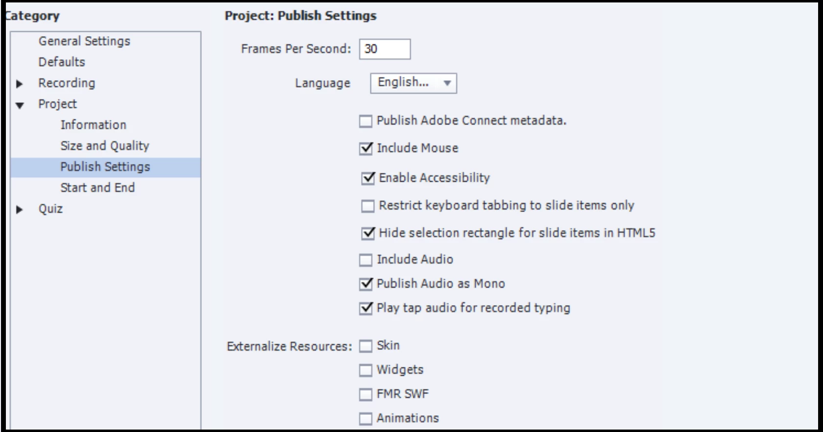

    Possible other reason after publishing may be that you didn't check to Include  Audio when publishing, as is the case i this example:
