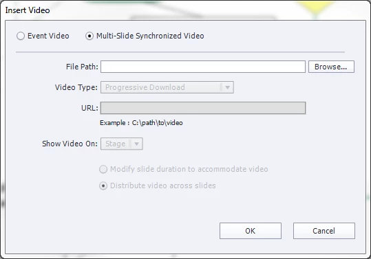

    How is the video placed in the project?
    Was it dragged to the library?
    Did you use an embed link in a YouTube widget? (These have been causing problems the last few days.)
         Issues with Youtube widget
    Did you use an embed link in a WebObject?
    or
    Did you use the Insert Video command on the Video menu?
    August 18, 2016
    I used the insert video command on the video menu.
