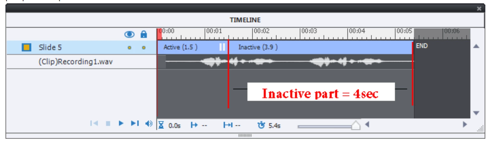

    Each quiz slide has a pausing point set by default at 1.5 seconds. You cannot change that point in the Timing properties as is possible for interactive objects. That pausing point will pause all visual object from appearing but will NOT pause slide audio. The playhead will remain paused at 1.5seconds.
    Did you extend the timing of the feedback captions?
    To decrease the waiting time, you can:
    • drag the pausing point to the right, but you'll have to do a bit trial and error testing to have the object audio attached to the feedback captions play completely
    • If you didn't have that the feedback audio, you could also change the Success/Last Attempt actions to 'Go to Next Slide' instead of Continue.
    Have a look at this screenshot:
    Because the playhead remains at 1.5secs, even after the slide audio has finished, if the learner submits the answer, and you leave the actions at Continue, the learner will have to wait 4 seconds before the end of the slide is reached.
