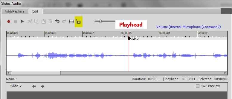

    Which option did you choose for recording? You should record 'to slides' and indicate the 3 slides.
    To adjust the slide transition, immediately after recording, which is done on the tab 'Add/Replace' go to the tab 'Edit'. You can cut portions, insert silences, but also indicate where the audio has to be moved to the next slide. For that workflow play the audio, pause where you want to start the next slide and choose the icon I marked in yellow, a marker will be inserted with the slide number. In the example of the screenshot you will see the marker for slide 2.

    I don't get that extra button that you highlighted.  My slide is a FMR slide and it's 5 sec long, the audio is 20 seconds long.  The extra button isn't on the edit tab and when I select Save, I get a pop up that says "Do you want to extend the display time to 15 seconds to match the new audio?"  If I say no, the audio is automatically cut to fit the slide, if I say yes, the slide length is extended.  Either way the extra button never shows up.
