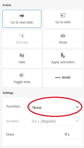

    Correct answer sharifsh
    Try disabling slide transitions for all the slides:
    That should provide temporary solution to the issue. However, this is clearly bug in the software. Hopefully, Adobe will fix it in the next update.

    sharifshCorrect answer
    July 20, 2023
