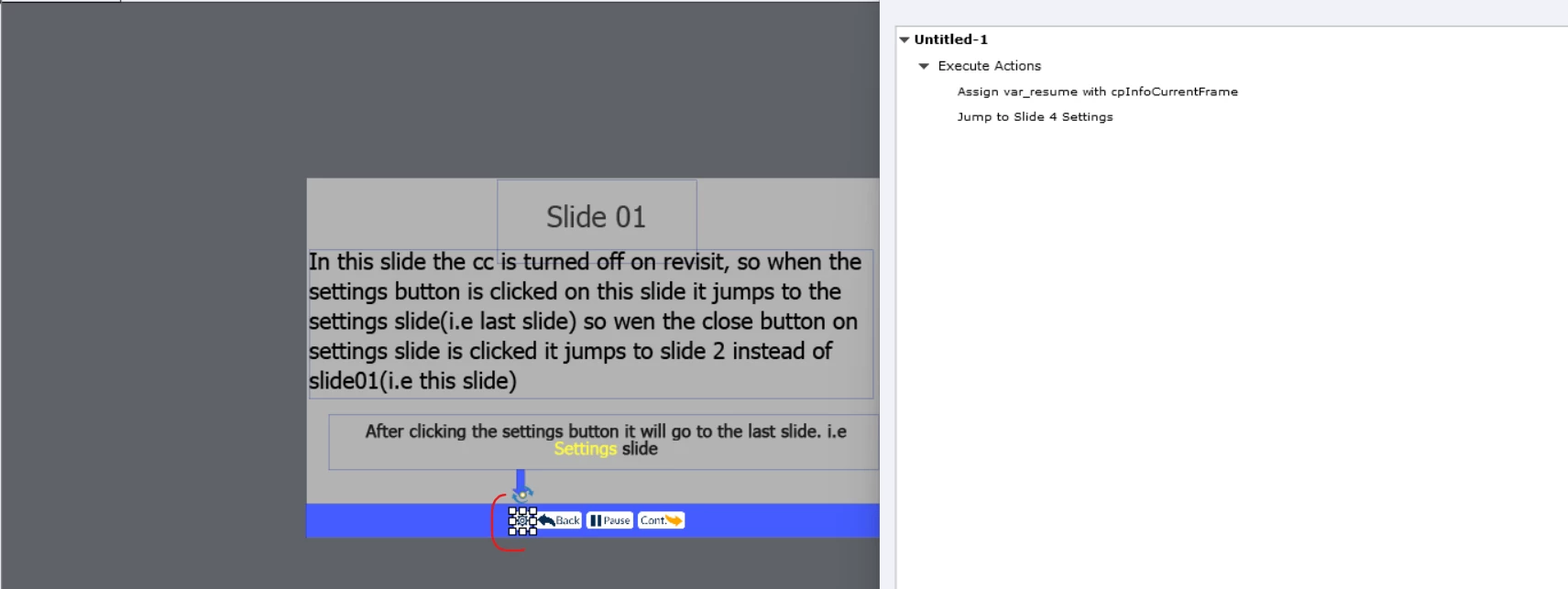

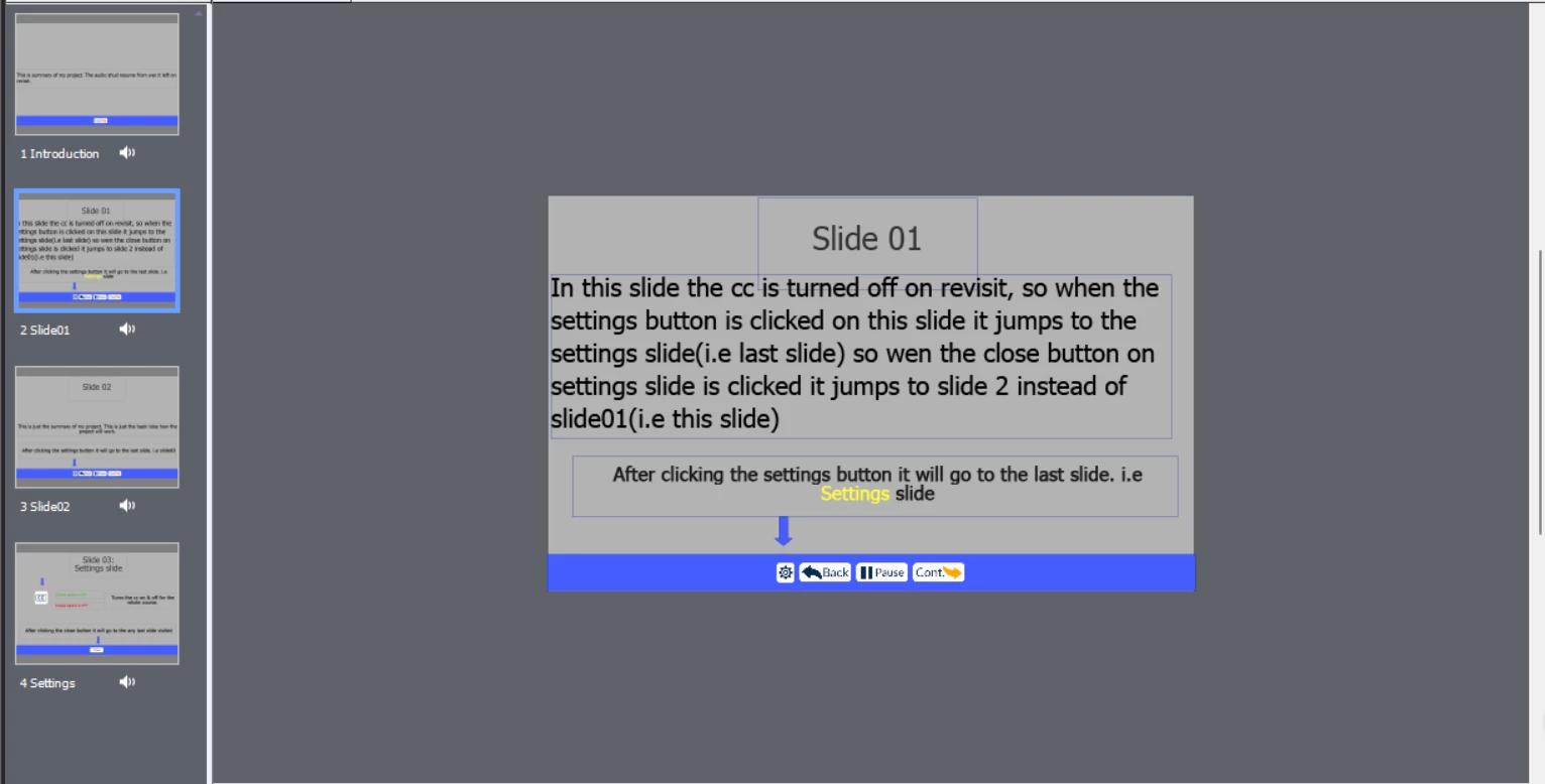

    1) In my project there are total of 4 slides, one is the introduction slide & the rest are normal working slides, on the 2nd slide is the navigation buttons i.e settings, play/pause, back & continue button and this navigation button is the same for the 3rd slide as well.
    2) On the forth slide is the settings slide, which has the cc on/off, sound on/off & toc on/off button. If we want to control the cc, sound or toc we can control this from the settings slide.
    3) On the second slide the cc will turn off on revisit, so i jump to 4th slide(i.e settings slide) by clicking the settings button on the second slide. And then i click the close button the 4th slide it directly jumps to the 3rd slide instead of the 2nd slide (this is the issue im facing). So if I want to go to second slide, then i have to use the navigation back button to go to the second slide. This is how my project looks.
    4) The trigger I used on the settings button is below

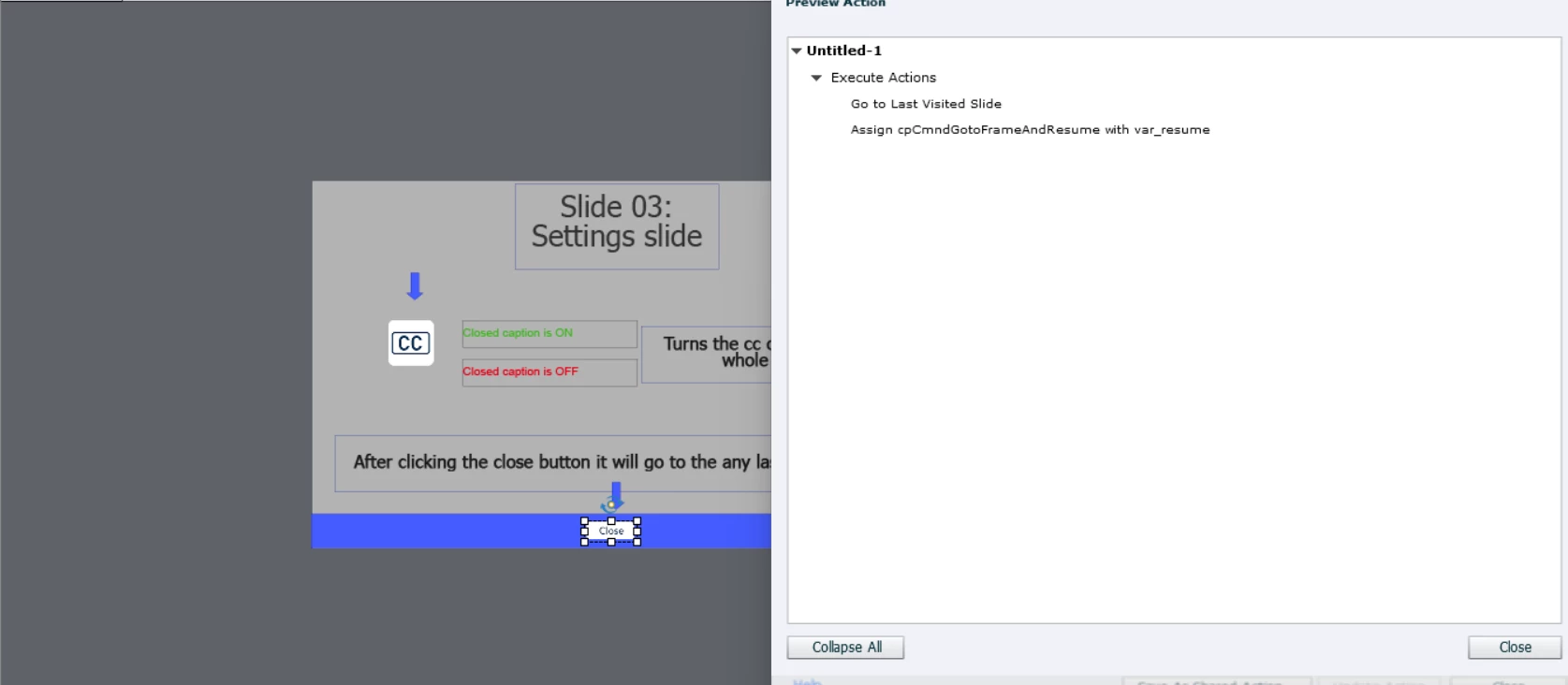

    5) The trigger used on the close button is below. I used this trigger so that wen i click the close button it will go to the last slide visited and will resume the audio wer it stopped but its not working properly.

    Why use two navigation commands i the Close action? Go to Last Visited slide is unnecessary, since you use micro-navigation to jump directly to the frame stored in the user variable.
