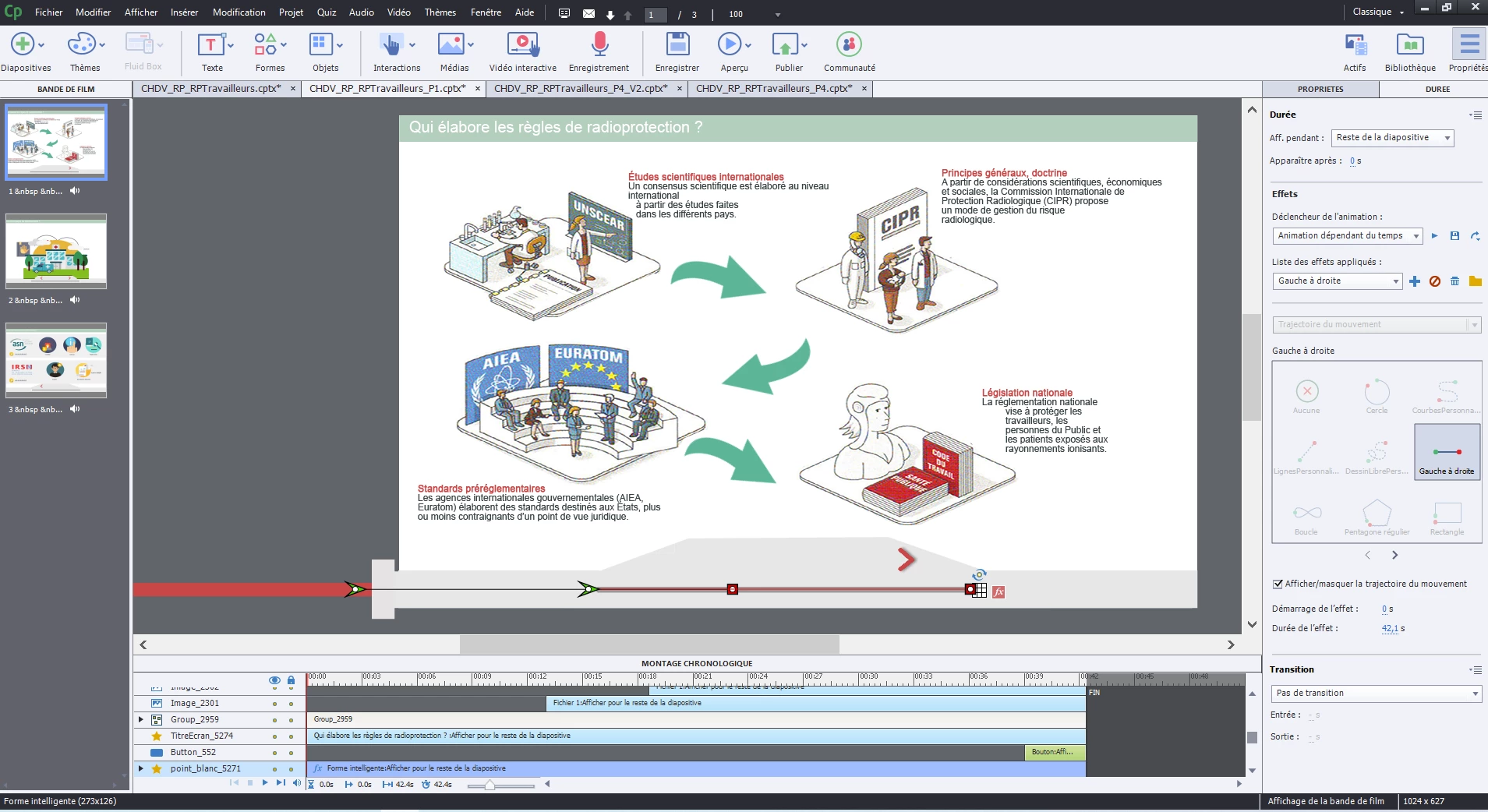

    Here is a screenshot of the first slide. The transition between the next slide should be only by clicking on the red button at the end of the audio.

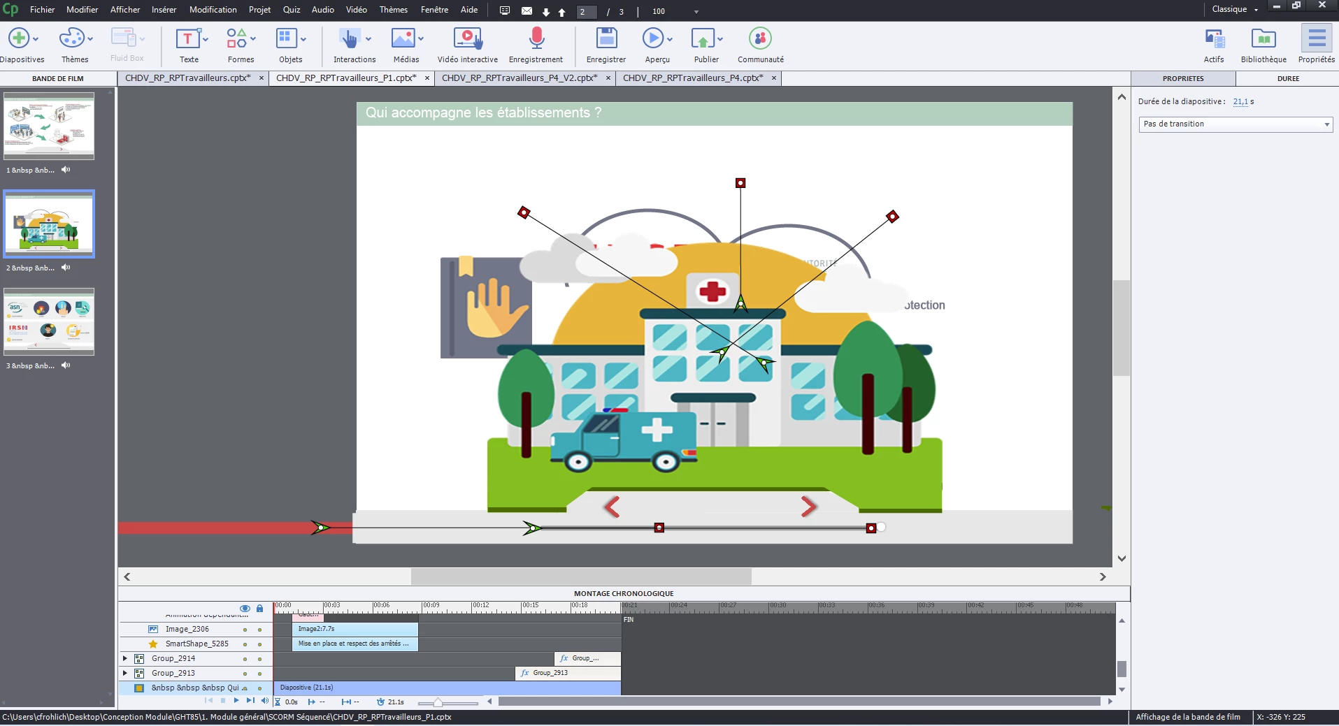

    And here is the next slide

    As far as I can see, the button has no pausing point at all. Select the button, go to Timing Properties panel and check if 'Pause after...' is checked. If not, check it, probably it will be set to pause after 1.5secs which woudl be possible since the button timeline seems to be about 3 secs.
    If you are new to Captivate, please read the blog post about pausing the Timeline, it could save you a lot of time cleaning up projects.

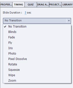

    Slide transitions within Captivate are located on the TIMING PROPERTIES window i.e.
    Mar 25, 2022 10:40 AM UTC
    Thank you @8206682 ! I've checked this point, and "no transition"is selected.
    So... that's not the point...
