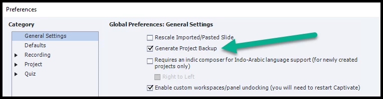

Do you have this box checked?

I have that box checked in fact.

I won't disagree that the process could be improved. The bigger concern I have, though, is the frequency of your crashing. I use Captivate daily - literally daily - and I do not have this issue of crashing all the time. I have only had two crashes in the last several years that I would consider as significant. In those cases, I did lose a little time but that backup file did "save my hide", as it were, on both occasions - awkward as it may have been to restore them. To be honest, I figure it comes with the territory. If I were you, I would want to figure out why it was behaving this way and solve the root of the issue. Autosave/recovery may be nice in some respects but I think it would only be a band-aid in this case. I would want to know if there is anything I was doing to cause it or if my hardware specs, other software such as an anti-virus, or perhaps some sort of corporate group policy were to blame. Based on my own experience, I am not convinced it is a Captivate bug at this point. I think you have a larger problem on your hands. Are you working with the most recent version of Captivate? Are you doing tons of copy/paste between projects? Is there any action you are performing when the crash happens that all the crashes have in common? That may help narrow down a search.
