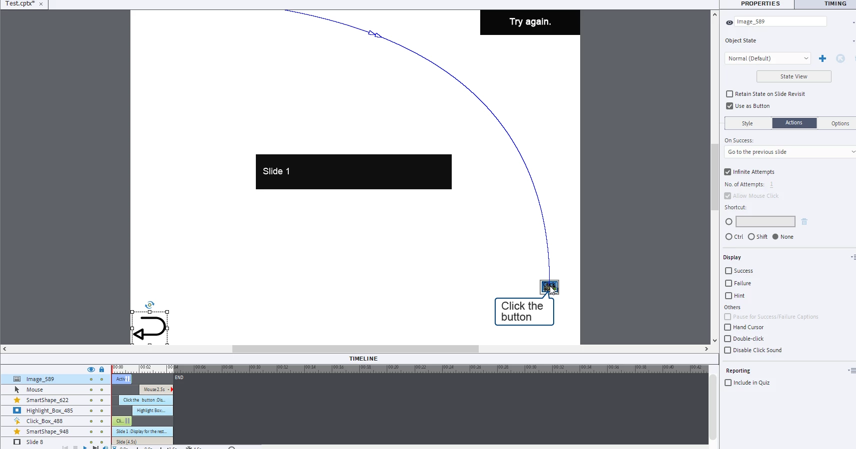

Im working on a project where I would need to add a back button to go back to the previous slide, I wanted it to be hiding and goes on when roll over and stays for the rest of the project.
I've added an image as button and set the action to go to the last slide visited and also tried go back to the previous slide. However, it doesnt work as intended as it triggers the failure from the click box on the same slide. It works if there are no clickbox on the slide. Can someone please suggest a solution. Thank you.
Please see attached video of whats happening. Cheers

    Sorry, lets ignore the fact that its hidden. so theres two button on the slide. one is the click box that proceed to the next slide and the other one is the image button which appears every slide (or possible set to stay for the rest of the project) and has the action go back to the previous slide.
    please the attached video and timeline

    Thanks for the video and image that helps.
    You need to set the image button that you are going to be using as your "Back" button to have "Timing" for the "Rest of the Project".
    Because you will also have other interacions on the slide, the image should not be set to "Pause After" a set time in the "Timing" properties.

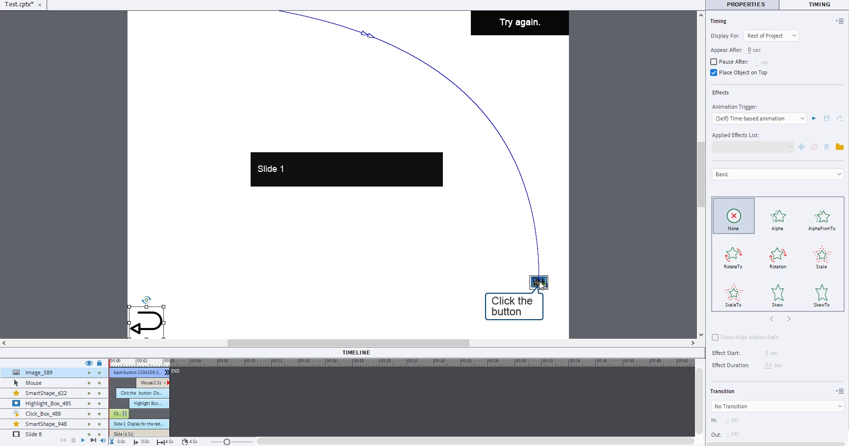

    May 2, 2024 1:43 PM UTC
    Thanks and apologies for a bunch of attachments.
    I've just tried that but it seems it is ignoring the fact that I'm clicking the back button and wants to go back to the previous slide/last visited. Please see updated attachments

    If you want the back button to appear for the rest of the project, that is something you can set in the "Timing" properties for the button, or as an alternative, you could add the button to a Master Slide.   Although if its initailly "hidden" how would you know that the back button was there?
    If the clickbox is being triggered, then its possible that you have made the clickbox is "in front" of other objects/interactions on the slide or too large that it covers the other interactions...

    No worries.  It may be a timing issue with the button(s) being used and the clickbox.
    Do they exist for the same amount of time on the timeline of the slide?
    Have you set the "Pause After" option for the button?  Clickboxes don't have this option and only pause if you have the option "Pause project until user clicks" sleected.
