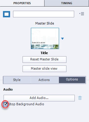

    By the way, you can stop background audio on individual slides, in case that helps with your solution. Using this would turn off background audio for slides where you may have audio triggered through a button or even slide audio.
