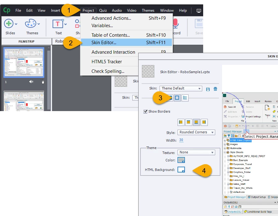

Hi, found some issues about background-color-problems (for example Re: Slide Color Problem when publishing to HTML5 ) but not exactly of my sort.
I create a non-responsive 16:9-Project in Captivate, Export it in HTML5 and view it in a Web-Browser on a Monitor with 4:3 Display-Ratio. The Project scales automatic for best fit, so there is Space at the top and the bottom wich do not belong to the Project itself.
But this space has - of course - a colour. Where is this defined?
Till today I thought it is defined in the color-scheme, but was not quite shure if it is really the color for Slide Background (german version says "Folienhintergrund"). But even if I set all colours in the scheme the same it makes no difference. In my case, I set all to blue, but background stays grey.
Another Idea of mine was to look at the Smartmasters (german "Folienmaster"), but I need a background-Image for the Captivate-Project itself and so can not define a color there.
I'm really getting a bit mad at this Point, because in another Project this colour is set right, but i have absolute no idea where a did sad it up. I am nearly sure that it has to be at Smartmasters or color-scheme ... but as I see it is not.
If anyone can help thanks a lot.
I will also look myself after it. Perhaps it is something in the Skin-Editor ... or I have to look at the exported code. But this should be the last option ...
    Correct answer Captiv8r
    Hi there
    Try clicking Project > Skin Editor > Borders Button > HTML color.
    Cheers... Rick

    April 11, 2017
    Thank you so much!
