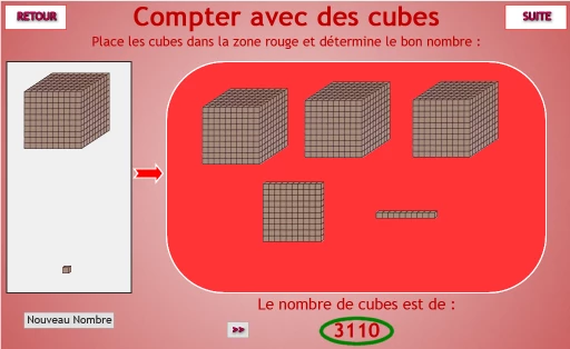

I'm starting to work with big numbers... I made a D&D slide in which I can put 1 000, 100, 10 or 1 blocks in a specific area.
And I have a variable which counts the number of cubes.
(Inspired by Paul Wilson's video : Drag and Drop Counting Game for Adobe Captivate 2019 - YouTube )
You can see this here :
Everything seems to work fine but my problem is :
=> I want my number to be 3 110 (with a space after the 3 first digit) instead of 3110.
As I will want to work with millions, billions... this will be more and more difficult to read for my learners without the spaces...
So I need you help !!...
Many thanks in advance !...

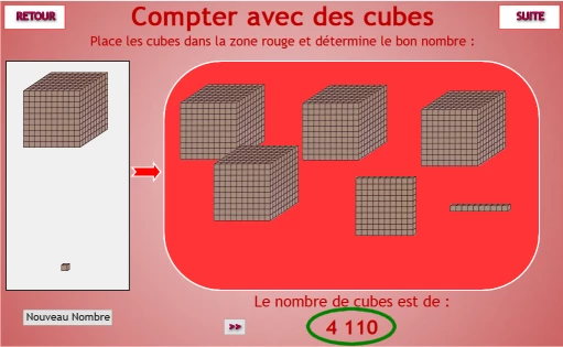

    Finally !...
    Javascript code :
    var nombre = v_Total_01.toLocaleString("fr-FR");
    And I show nombre in the Text Caption, instead of the variable v_Total_01...
    It was so simple that I spent my all afternoon on this !!!...
