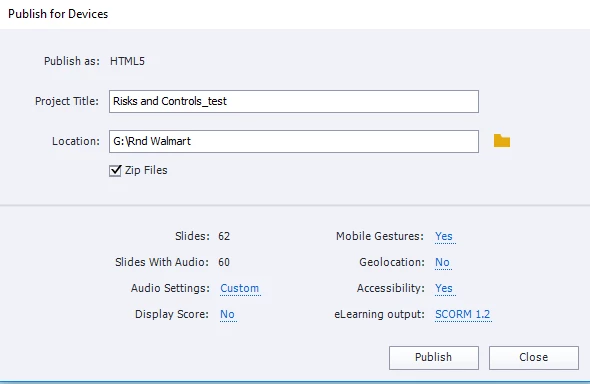

The book marking is not functioning properly, It is working till slide 26 after that if I move to next slides(27, 28 ....) then close the course and relaunch it again in SCORM it resumes on slide 26. (Note : We don't have captivate player, we have made custom player for this) below are the publish settings.

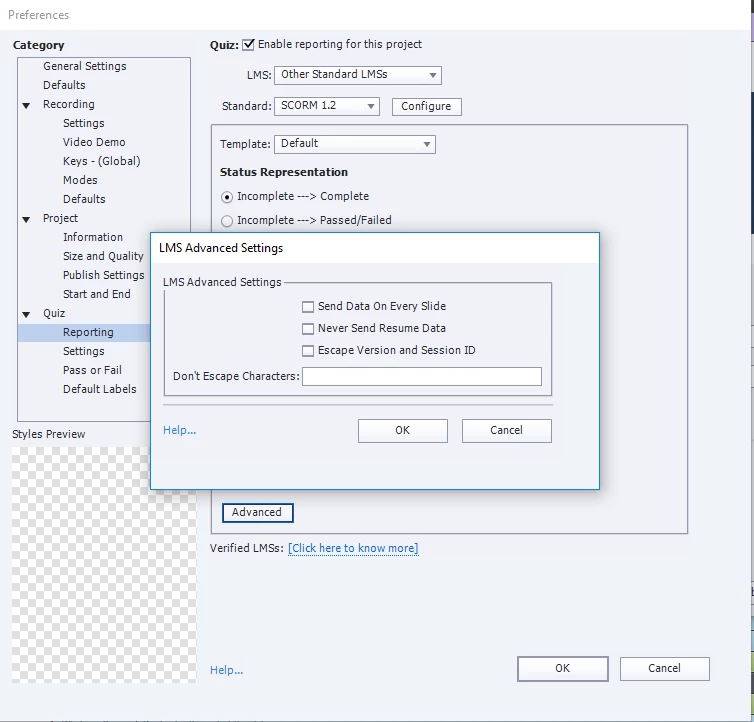

Nandhakumar S
Feb 28, 2018 11:16 AM UTC
Please check this screenshot options.
1
RodWard
Feb 28, 2018 11:28 AM UTC
Self-paced Learning bookmarking is not the same as Resume Data Bookmarking (as used by LMS).
When you activate Resume Data Bookmarking, Self-paced Learning Bookmarking gets ignored, even if you happen to have it turned on in the Skin Settings.
Self-Paced Learning bookmarking stores cookie data on the end user's PC in their browser's Local Storage (or via Shared Objects if the content is Flash SWF).  However, Resume Data Bookmarking stores the data in the LMS database.
They are two very different animals.

What is on slide 26? You covered up the settings in the screenshot. What are the criteria? If you have a Quiz, what is the setting in the Field 'Required'?
What do you mean by 'Captivate player'? Captivate AFAIK has no player, you publish either to SWF, and it will be launched by a htm file, or you publish to HTML and it is launched by a index.html file.
Feb 27, 2018 1:53 PM UTC
This is a responsive course, it shows only html5 output. there are no quiz.
